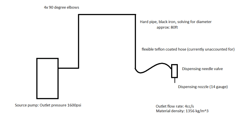

I'm working on a problem in which I am trying to recommend a hard pipe diameter to a customer for a (relatively) high viscosity non-newtonian fluid.

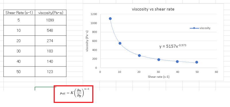

I am treating it as a power law fluid and have obtained constants K and n to describe the viscosity in relation to shear rate. I also have desired discharge flow rate, inlet pressure (outlet pressure is zero, right? It's being dispensed from a nozzle.), approximate pipe length, and nozzle size.
I've written some python code in order to help my calculations and here's where my issue is coming in. The Reynold's number I'm getting is on the order of 10^-6 which raised a red flag, and, my friction factor is about 9,000,000 so another major red flag. I am using 64/Re for the friction factor calculation. Using a different equation for friction factor like colebrook can give me a more reasonable friction factor, but doing so also yields a suggested pipe diameter that is far too small (based on practical experience).
Anyway, I'm not sure if I'm approaching this problem right at all, as I'm treating it as almost entirely a pipe flow problem. I think I probably don't have the right terms in my equations to account for the heavy neck down to the 14 gauge nozzle, but I can't seem to dig up any relevant information.

n = 0.027 # constant obtained from viscosity vs shear rate plot
K = 5157 # constant obtained from viscosity vs s hear rate plot
