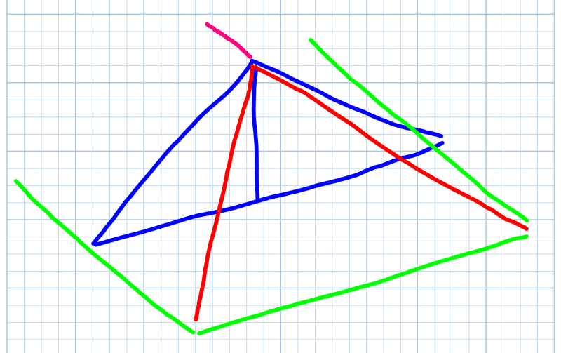

You could have a king post truss (blue) pick up the hip girders (red) on each side of the ridge (magenta). I out sketched one half of the framing:

Bones - That's one idea I've considered. I think it offers a more easily understood (for my mind anyway) load path and force resolution.

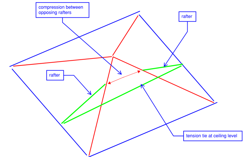

Pham - 1. See sketch below. Where the opposing rafters do not meet due to intersecting with the hips is the compression between these opposing rafters resisted by the diaphragm? Does a couple rows of blocking in this direction at each side make sense to help stiffen this?
2. I assume the stiffness of providing a rafter/tie system is what prevents the hips from acting like beams and resulting in large hip thrusts at the corner posts that needs to be resolved in a "tension ring"?
Correct - the diaphragm ends up resisting that compression. Note that where the compression will be highest (longest rafters), the length of the compression element is shortest. Some blocking will help if you are concerned about it. I usually require blocking in rafters anyway to avoid problems with uplift.
And yes, if you have adequate ties, there won't be any outward thrust at the hips.
