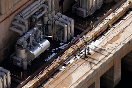

Looks like a transformer let go.
Link
old field guy
So? Not a big deal.
hokie66-
You know that and I know that, but it made the news cycle. I don't think it was much of a transformer, judging from the smoke cloud.
OFG
old field guy
Fortunately, there wasn't enough water behind the dam to put out the fire.
not sure water is recommended on an electrical fire
it's OK, there isn't any...[lol] Actually, I think they have about 50' 100' to go...
Yea, they played it up on the local news but as anyone could see, it was just a transformer and the photos taken afterwards didn't really show all that much damage, just a lot of soot and foam covering the area.

They surely designed for a higher ambient temp in that location. 40°C is the standard ambient design for electrical machines and there are 50-65°C standards. We do 50°C for marine applications.
Are those the same transformers installed in 1935?

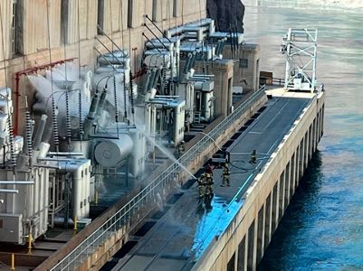

Look closely, Transformer has only left 2 bushings, right bushing you can see the power line leaving, but not the right bushing.
Too bad transformer deliveries are up to three years.
Probably doesn't need replacement, but repair in place.
spsalso
Yes, that Right phase line looks like where all the action was. The insulator at the bottom of the power line leaving the station is all covered in soot and, as you noticed, the line from the transformer is missing.

How is there a big red manifold with sprayers up on the wall just for that one transformer??
Keith Cress
kcress -
Soaker hose cooling system?
The transformer is different from the rest. Perhaps it has a flammable oil and the others do not.
What transformer oil is not flammable?
Good question I guess. I assumed PCB's as well as other halogenated oils to be non-flammable but that appears to not be the case.
I don't think non/less flammable oil helps much in case of a high energy fault. It does limit the fire damage after the protection stops the arcing fault.
[URL unfurl="true" said:
https://www.transformer-technology.com/community-hub/technical-articles/1398-transformer-bushings-breakdown-mechanism-and-the-appropriate-life-cycle-maintenance-implementation.html[/URL]]According to studies, bushings cause 17% of all power transformer failures and are the third most common reason for transformer breakdowns. High-voltage bushings contribute 30% to all fires and explosions associated with power transformer breakdowns.
Since it appears that one of the bushings is 'missing' and the insulator that was securing that right-side phase line appears to be heavily charred and which would have been close to said bushing, it would seem that the bushing was indeed 'involved' in whatever happened.
