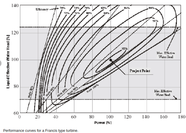

But you know things do fail. And with the lack of water, it is likely that any one unit could be taken off line without a constraint that the water level doesn't already offer.
As some point the water gets to low to spin the turbine.
[URL unfurl="true" said:
https://en.wikipedia.org/wiki/Hoover_Dam[/URL]]Under its original design, the dam would no longer be able to generate power once the water level fell below 1,050 feet (320 m), which might have occurred in 2017 had water restrictions not been enforced. To lower the minimum power pool elevation from 1,050 to 950 feet (320 to 290 m), five wide-head turbines, designed to work efficiently with less flow, were installed.[102] Water levels were maintained at over 1,075 feet (328 m) in 2018 and 2019,[103] but fell to a new record low of 1,071.55 feet (326.61 m) on June 10, 2021[104] and were projected to fall below 1,066 feet (325 m) by the end of 2021.[105]
LOWER COLORADO RIVER DAILY REPORT: Current Month (Daily Data)
If I read the report correctly, current pool elevation is 1040.69 ft
I understand that happens if it drops another 100' and at 150' the river stops flowing...
The good news is that the tail race level likely will not limit any power production.
