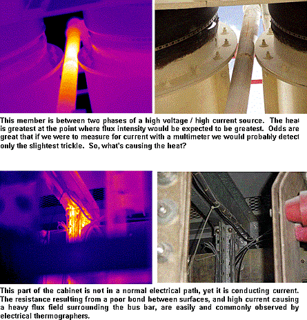

davidbeach:
I can't imagine it being anything BUT induction heating. Fits with slight non-symmetry as compared to the other side and they'd never mount anything between those two feed-throughs as there'd be bolt holes if they had.
Keith Cress
kcress -
Keith,
Very interesting, I didn't realize inductive heating could be so dramatic.
Here is an article that discusses the effect and includes some photos.
And another one:

Hi Keith,
That looks the isolated phase bus duct between a generator and it's step-up transformer. The scaffolders at our power station did something similar, making a closed loop around part of the IPB for a 300MW generator with nearly 16kA flowing in the bus. He formed the loop outside of the cross-bonded section where there's no image current cancellation effect. The report was that the tube got hot enough to burn his hand, and when he jolted it there was a blue spark. Poor guy was pretty shaken by the experience. They'd gone a bit higher up than they should have, trying to get ahead on the job.
As ScottyUK suggested, a closed loop of steel around a conductor can flow a lot of current - it basically creates a 1-turn transformer. I once measured about 250A flowing through a unistrut completing the circuit around a conductor with 2500A flowing.
Considering that it's likely 1200A or less @ 50Hz or 60Hz just passing by, I would put more belief in the above than in believing the current in the bar is inducing eddy currents that only circulate locally inside that strip of steel. It might contribute, but I find it hard to believe it's solely responsible for that much heat.
It's odd the manufacturer wouldn't know this happens. The similar pass-through location from Schneider has one big insulator for all 3 breaker bus stabs to avoid that exact problem.
It doesn't have to be encirclement or a closed loop. In Keiths top left picture, the intruding bar or pipe is hottest in the area of the strongest flux. This suggests local eddy currents. This effect may also be present in non-ferrous material. An AC flux will induce a potential with the resulting eddy currents in any conductive material. It is, of course, a much stronger effect with a ferrous material forming a magnetic core.
If the current was caused by a closed loop the same current would circulate in the loop and the entire loop would be hot.
Bill
"Why not the best?"
Jimmy Carter
I would expect the bus in Keith's first pictures flows A LOT more current than the bus in the OP's enclosure so I could believe local induction there more so than the OP's picture. However, without seeing the whole structure it's hard to know if that bar forms a closed loop or not. Structure that acts as a heat sink at each end of that bar can explain why its the hotter in the middle. Same with the enclosure picture, no-one can say if there is a loop around a single phase or 2 phases of bus from the picture.
I ScottyUK's hypothesis above regarding the OP's pictures. I suspect the design called for a stainless steel plate here, but a steel plate was mistakenly used during assembly.
