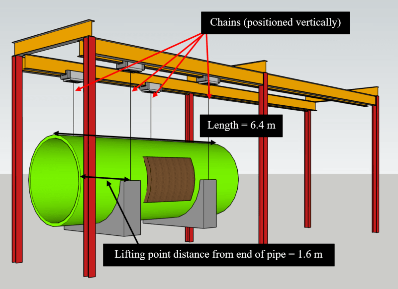

rb1957 The chains will be positioned vertically, I did a small error on the previous drawing - just spent some time to correct it and here how it looks. I also did a small error in the weight of the pipe and corrected it. We have the following:

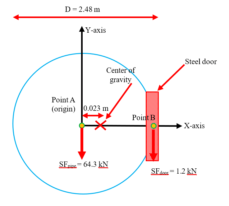

We know that:
- Weight (self-weight) of the pipe is 64.3 kN (6550 kg)
- Weight (self-weight) of the door is 1.2 kN (120 kg)
- Total self-weight of pipe and door is 65.5 kN (ignore the saddles for now).
From the calculations, we also know that the center of gravity due to the door attachment will shift 0.023 m to the right from the center point of the pipe (If we assume the datum is the center of the pipe only).
I am trying to work out the load each chain will take in order to put them as point loads on the steel beams. We know that the chains to the side where the door is located will take slightly higher point loads than the other side
What confuses and cannot work out the load in each chain, is how to consider the shift of the center of gravity (0.023m) due to the door. Lifting points are at quarter points (1.6 m from each end of the 6.4 m pipe).
think about it ... I'm not going to do it for you.
I've said each end (with two chains) reacts 1/2 the load ... and you understand why ?
Look at the structure in the YZ plane ... things appear, at least, to be symmetric.
So consider each end in the XY plane, with two chains and 1/2 the load, as a simply supported beam; look this up if you don't know what that means for the analysis.
The load is positioned at the X CG, slightly off the mid-point between the two lifts.
I may have confused you as I had mentally up the Z axis up, X along, Y lateral (to the Left, why?)
and what are the two grey things, joining the lifts ...how much do they weigh ? ('cause the chains supports their weight too)

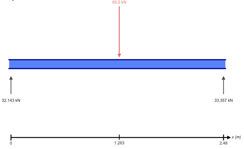

I took the XY plane put the total load of 65.5 kN (sum of pipe and door) on the shifted center of gravity point as shown above. Then, I solved it as a simply supported beam.
If this is correct, then
16.0715 kN on the each of the two chains located to the side of the pipe without the door
16.6785 kN on the each of the two chains located to the side of the pipe with the door
(16.0715 x 2) + (16.6785 x 2)= 65.5 kN..no?
that seems reasonable.
what about the grey things (joining the lifts) ?
