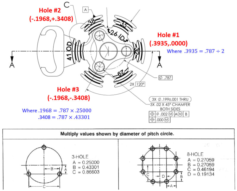

Hi, I am having a hard time understanding the true position for the Ø.199 holes in this drawing and how to measure them during inspection.
When the hole diameter is the smallest allowed or at MMC(.198) the center position of the hole can vary by Ø.002 from the true position. Is that correct?
What does the lower True Postion / .000 MMC block mean?
What's the best way to measure this using a Vision System?
What about using a functional gauge? Would the pins be Ø.197? What would be the position of the pins?
Thank you for the help!

1. ASME Y14.5M-1994
2. I have read section 2
3. Datum A is the outside face of that cylindrical surface
4. Datum A is Ø1.614 ±.005. Same dimension applies to the other 4 portions of the circle.
5. Datum B is the flat surface on the opposite side of this view.
6. STARLITE GX OPTICAL MEASUREMENT SYSTEM
Before your inspection, you need to find out the basic dimensions of each hole, so you will convert the coordinate system from polar to traditional as shown on the figure below.
The upper segment position tol allowed is Ø.002 at MMC while the position tol allowed on the lower segment is Ø.000 at MMC.
As ewh mentioned, the lower segment controls the spacing within the hole pattern.
Absolutely, functional gage will be a better way on your case, since there is a MMB modifier on the primary datum feature, it will save your hard time to calculate the datum shift allowed and analyze on the hole pattern acceptance. But you need two gages on this case because of each segment of a multiple single-segment position control must be verified separately.
The gage pin size and its position of the upper segment is 3X Ø.1960 +.0002-.0000, |POS|Ø.0002|A|B|, and for the lower segment is 3X Ø.1980 +.0002-.0000, |POS|Ø.0000|.
By the way, 2X120° need to be changed to 3X120°, and the diameter symbol missed on the lower segment FCF. Hope my 2 cents will help you.
