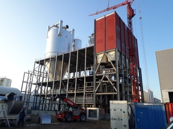

Hi there,
I've read a few forums on this topic and see that some people create models where chevron braces are not taking any axial load from gravity forces. My question is if there is considerable gravity load acting at the point where your chevron braces are connecting to your beam, (say we are talking about a machine frame where the heavily loaded feet stand directly above your chevron brace) and in reality a lot of this load will be transferred to the brace then what would be your preferred method of design:
1)design the braces for those axial loads resulting in large braces compared to the beam sizes
2)specify in the procedure that the braces be installed only after the beams have been fully loaded so that they do not take any of the axial
Design the chevron brace taking both lateral (wind/seismic) and gravity load from tbe equipment like your typical global analysis. Do a separate local beam/connection design without the brace for gravity/equipment load only.
This is written in standard design guide for vertical brace of EPC firms.
Design the braces to take both gravity and lateral forces because most likely you won’t have control over the order they erect and set everything. We like to keep our unity ratios to a 0.5 max on WT’s rotated because of eccentricity, double angles and W beams is fine to go up to 1.
Unless the bracing is extremely light then I definitely design the braces to take the axial load. I certainly don't design the beam for gravitational in the absence of the braces. That is akin to designing the cord on a warren truss to take the full bending load. It makes no sense.
If it is a tiny frame with minimal lateral loads then the lateral bracing just goes along for the ride. But I'm talking a 3x4x2.5m equipment frame.
Human909, have you had any experience in petrochemical industry to say it doesn't make any sense? It makes a lot of sense and the people who made these design guides have several years of experience in the industry. The reasoning is there are times vertical braces maybe asked to me removed during maintenance or turanaround of equipment. And it doesn't really cost much extra to design these few beams for gravity without the bracesa and good redundant design in this case.
It is a requirement for seismic design. The intent being that during a design level earthquake we assume that vertical braces yield during the event and are no longer able to support the gravity load (or at least lose a large portion of their strength). So you must design the beam to support the full gravity load assuming the braces are gone.
Its not yielding small amounts of drift will shed load to the beam and column. However, if you do have a large point load at the brace connections and I do mean large you should consider including that load in the braces. This is when considering seismic loading
Thanks for all the info everyone. I will take both loading situations into account and design the braces for the axial loads and the beam for gravity/equipment loads without the bracing. AskTooMuch, do you know if there are any of those design guides of EPC firms you mentioned for free download online?

Certainly it is common to support 300+ tonne silos using chevron braces, where the beam above has no chance to support the load. And while you might look at that and this that is a soft bottom story, well yeah it is. That is a necessary requirement so it is designed as such.

Given that I regularly put chevron braces in specifically as a vertical load path, especially for retrofit work, it would be weird if I ignored the vertical load on them in other times when it's not convenient.
The braces are going to be a stiffer load path than the beam, in most cases, so you'd need some really tricky detailing to shed vertical load out of them.
I can see that a large ECP (starts with an f) would put that in design criteria, but that doesn't mean it's common practice or even logical. If you need the chevron not to take dead load, you can ask them to install the equipment first, but otherwise it is always designed for this. Given that any time bracing is removed without engineering input it has the possibility to create serious instability, the beam yielding when the bracing is removed is the least of your worries.

I don't think anyone is saying to not design the braces for the imposed load. But for US seismic design codes (ASCE 7, AISC 341, etc) you can't rely on the vertical part of the seismic force resisting system to carry gravity loads for certain types of vertical bracing. Steel specifically. IIRC, braces are expected to have around 30% or 40% of their compressive strength remaining after a design level earthquake. Buckling of the brace and yielding of the gusset plates are part of the mechanism. Tension yielding of the brace the other component.
I'm not saying there's anything wrong with using a vertical brace or leaning column as a part of the gravity system like your hoppers, just saying that in some circumstances you can't rely on that brace's contribution support gravity loads. Emphasis on "in some circumstances".

Chevron braces for wind resistance are very different than chevron braces for seismic resistance. The reason being that for seismic design you expect your members to experience demands beyond the normal loading you design for. And, you rely on the SYSTEM (i.e. Chevron bracing) to have ductility post member failure.
And, there is A LOT of good literature showing what happens to Chevron braces after one side buckles (during an earthquake). The buckled brace loses almost all of it's compressive resistance, but the structure still deforms in that direction. Which then means that the tension force in the other brace keeps increasing until it pulls down the "gravity only" beam.... unless the beam is designed to resist these additional loading.
