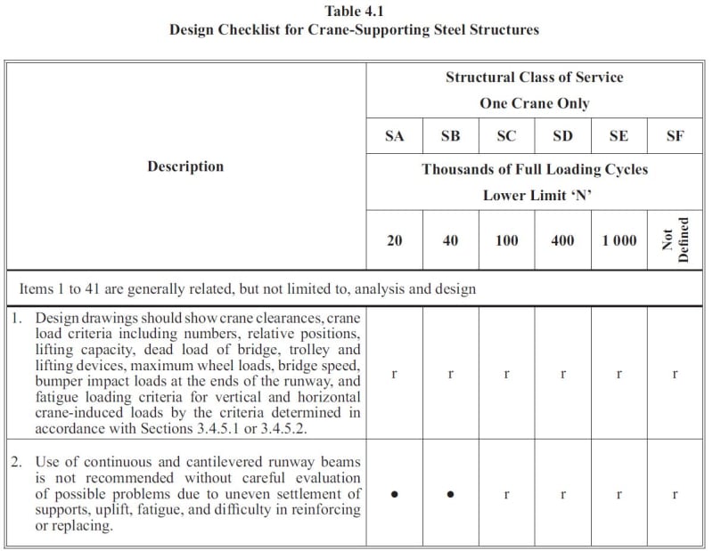

From the CISC Crane manual, they mention use of continuous crane beams with a caveat. From a design point of view, the stress caused in the bottom flange of a +ve moment on a simple span and the -ve moment over the support is 77% approx, and introduces these other issues. Unless for very light loads or infrequent usage, I've always gone simple span. Others may have other comments.

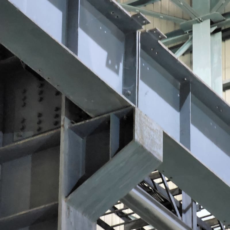

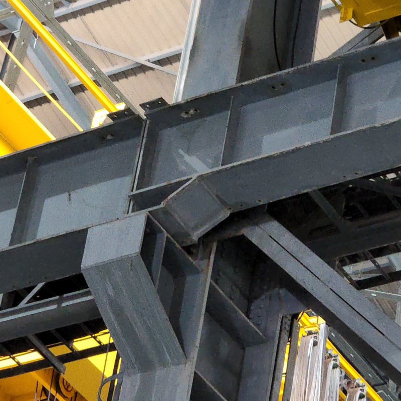

Below are pics of the runway beam of a 105 ton EOT in a nearby power station where the stiffeners are welded to the top and bottom flanges and for the entire web height. These photos were personally taken by my team.

edison... just because you can, doen't necessarily mean that you have to. [pipe]
but it also doesn't mean that you Shouldn't. It looks to be personal preference.
The nuance could well be that there are details in the design welded to the flanges that are not obvious and if not incorporated (by an unaware designer) could be dangerous.
And dik prefers to use web stiffeners to distribute load into the web (and less as panel breakers).
Looks like you have most of the major things worked out.
I'll just reiterate my previous statement that we've found it's more economical in today's environment to thicken the web to eliminate web stiffeners for shear. It might be something to consider for the runway beam design, since the loading conditions are fairly similar.
I suspect that material is still more expensive than labor in India, which justifies using stiffeners to save on steel - not so in e.g., the US or most of Europe.
Edison: the detail does not make much sense. Your supplier has either misunderstood the purpose of vertical stiffeners or not thought about the details in the first place. There is research on this subject, and it clearly shows that cracking and fatigue is amplified in welded joints connected to the flanges. Those types of connections also create a vertical stress in the stiffener and the flange and depending on loading conditions, also lateral stresses. Beams are usually designed with dimension reduction models that incorporate only stresses acting in the longitudinal direction (normal stress sigma_xx and shear stress tau_xy=tau_yx); not even using shell elements will save you from trouble, since they do not include through-thickness stresses and deformations.

I'll agree with you on welding to the flanges, also. Welding to the flanges doesn't help the shear capacity. If they help keep the top flange from twisting, I can understand fitting them tight to the top flange, although to avoid severe stress risers in the flange-to-web welds at the stiffeners, we always clip an inch or more off the inside corner of the stiffener and if we weld them to the flange (when used as connection plates for diaphragms), we hold the weld back 1/4" from the clipped edge.

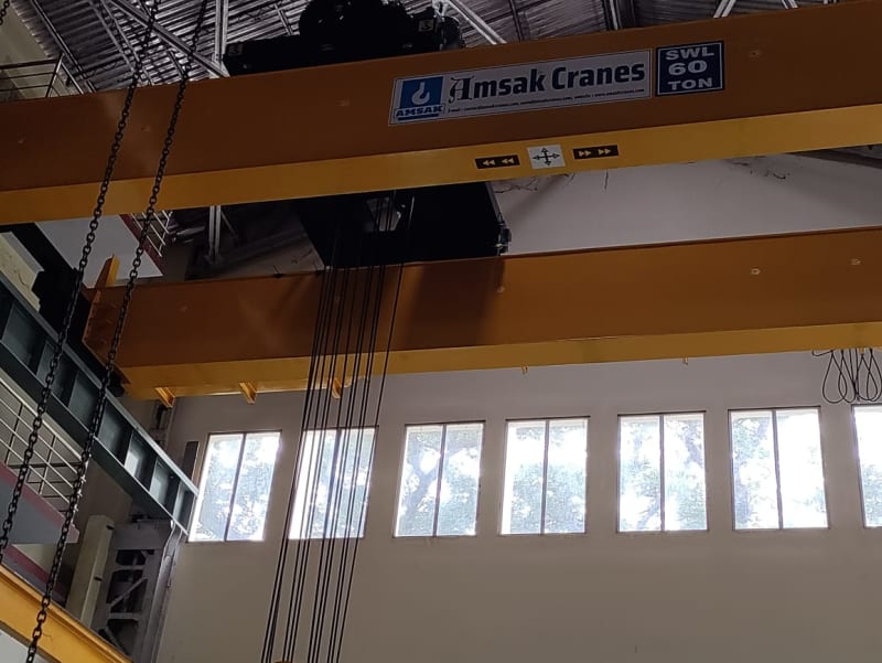

Update: The 45 ft span, 40 ft lift, 60 ton EOT crane has been designed, built, installed and commissioned successfully in my motor repair shop all within 10 weeks. The total weight of EOT crane is about 27 tons. The picture showing the crab and the LT beam is below. As discussed, I insisted on a cap channel on the LT beams top to arrest lateral sway. The maximum center deflection of bridge beams was 9 mm with 63 tons at the middle of the span. The crane supplier is well experienced with a great infrastructure and addressed all my concerns very well.
Thanks again for all your tips.
Muthu
