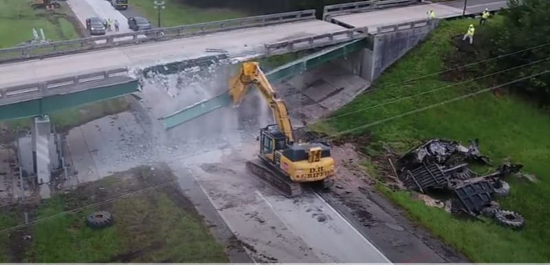

The SR86 bridge over I16 in Treutlen County, Georgia, was shifted six feet when hit by raised dump trailer on July 15, 2021.
Efforts are underway to demolish the entire bridge so the I16 can be partially reopened by July 17.
Wow! I can see demolishing and replacing the concrete deck, but it seems like a large part of the steel structure could be saved and moved back into place. It would be interesting to see some pictures of the underside of the bridge and learn the justification for a complete demolition.

That portion of I-16 was built in the mid-'60s, so age will partially justify complete replacement . It's hard to tell from the available pictures if there's a lot of damage to the steel structure. There's a little curve built in, and the depth of the beams gets deeper near the center support. I imagine the momentum of the truck and/or trailer frame could have lifted them into the framework with considerable force.
Any idea on how they'll go about demolishing the bridge? How much does something like that weigh? Could a mobile crane lift an entire span to simply set it aside?

Stack some cribbing, jack up the moved end a bit and winch it over a few inches. Reposition jacks and repeat til back in position. Probably one of the easiest heavy lifts out there as all undesirable motion is restrained.
Of course I have not looked at it except from photo!!
