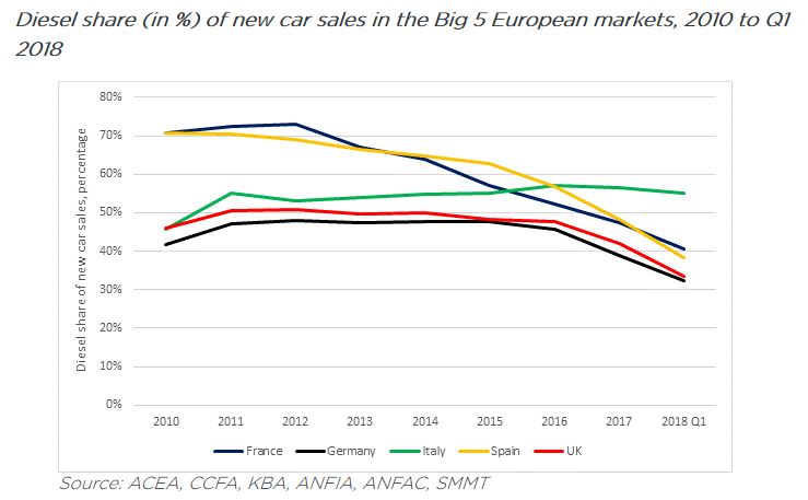

I wouldn't count diesel out just yet. It's always held low market share in the US, but it still represents a significant share of sales in Europe. It's declining in popularity there, but industry analysts expect it to plateau soon. A key factor in this is that much of US oil is light crude preferred by gasoline refiners while diesel as opposed to the heavy crude preferred by diesel refiners. This is why diesel costs so much more than regular gasoline these days in the US... why go diesel when it's improved efficiency is offset by increased fuel cost at the pump?
Interesting that diesel sales in Spain are still above 50%. Any idea why?
"How much start enrichment is applied?" - on new engines there is almost none, even on a cold start. The manufacturers have the EFI systems very well refined.
In many jurisdictions farmers and home furnaces access a substance that is remarkably diesel like but on which no or little excise is payable.
It may be that in less policed jurisdictions that diesels have an economic benefit to the owner not available to their gasoline burning competitors.
