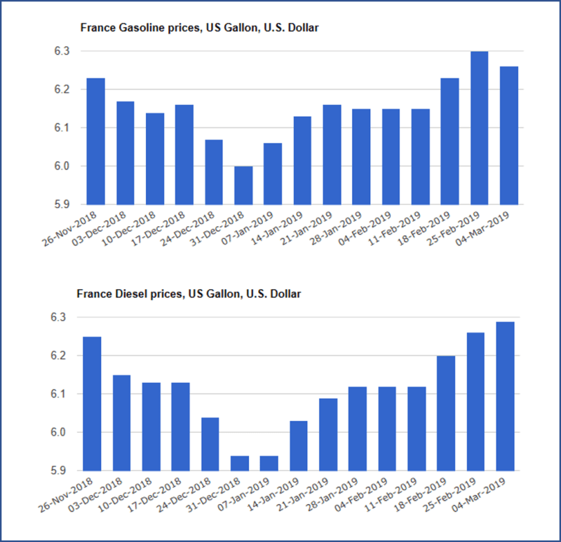

Diesel cost? Back in the old days in the US, diesel was always half the cost of gasoline, I remember as a kid diesel at .14 a gallon and gas was around .25 or so(that is cents). It has magically gone up in price, in some areas it can be a few cents or more less cost than gasoline. Depending on the state there are special petroleum taxes so price varies.
The sign outside my window prices diesel at 21.5% more than gasoline almost wiping out any efficiency benefit from the diesel cycle.
" diesel at .14 a gallon and gas was around .25 or so(that is cents)"
Holy crap .25 cents per gallon!
je suis charlie
The difference in price between gasoline and diesel is very different in Europe. I have read that the US difference is largely due to the fact that we're awash in light crude (preferred for gasoline) and comparatively low on heavy crude (preferred for Diesel).
