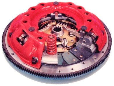

Apologies for asking a possibly common flywheel question: my car forums of choice are vastly under-qualified to help. My question is twofold: How likely is it that a 23 lb (mild steel?) flywheel turned on a lathe (improper tool) or ground (proper tool) would become out of balance significantly enough to cause the entire driveline to vibrate? How much imbalance would be necessary to cause this situation?
The car is a 2.5L H4 AWD (Subaru WRX).
I recently had my clutch changed at a shop which sublet the flywheel resurfacing to another shop of unknowable quality. The service manager inadvertently informed me that no shops in the area are capable of balancing flywheels of "that size." I assume they must have ground the surface because the clutch does not slip.
I've done a great deal of googling trying to understand the issue better. I don't have access to a vibrations text, only my notes from the class. So I have the equations of motion, but lack the experimental capability to characterize the constants. Ultimately, I'd like to use Shigley's to make some prediction on the increased fatigue life of the crank. (I've yet to apply ISO 1940/1 which was suggested in another forum for predicting amplitude of vibration of a pump rotor.)
Thank you for any information!
tipping a well balanced flywheel on the crank would induce some "couple" unbalance, that would have a relatively small effect on the longish crank/flywheel assembly unbalance. If the shop that refaced the flywheel did so with swarf between the table and flange, they'd remove more material from one side and create static or single plane unbalance right at the flywheel plane.

I can't remember the exact spec for engine assembly out of balance, but from memory it was of the order of 10-30 g cm for both ends of the crank.
Now, that is for an engine built from a balanced crank and a balanced pulley and a balanced flywheel, and we still ended up balancing the flywheel plane for EVERY engine after assembly.
So, fully machined parts assembled to a balanced crank can and will cause detectable vibration. Whether they would cause destructive levels of vibration is another thing entirely.

Thanks Greg, this just reaffirms the old "you get what you pay for" adage. Soon, a brand new OEM FW should be installed, and my hope is that this will restore the balance.
Can you explain why so many people manage to get away with machining their FW without noticeable issues? In my case, I would absolutely venture that the fully machined part was fully machined improperly considering that the vibration has proven destructive: a recent development is a pretty loud intermittent squeaky sound in low gears in low rpm ranges. It's probably a bearing. Since I don't know which and subsequently don't have the part, I expect this will become a problem in the future. I can only guess at what will happen when it fails.
"Can you explain why so many people manage to get away with machining their FW without noticeable issues?"
It actually takes fairly sloppy machining technique to get it wrong. Any machinist who cares more than a jot, will observe the sound at the beginning of the grinding operation. Any runout will be evident as an intermittent sound.

Grunt, I was directing my query to "Now, that is for an engine built from a balanced crank and a balanced pulley and a balanced flywheel, and we still ended up balancing the flywheel plane for EVERY engine *after assembly.
My comment was assuming the situation under discussion where a well-balanced motor has the flywheel removed, machined and refitted. It should remain well-balanced if the machining was accurate.
