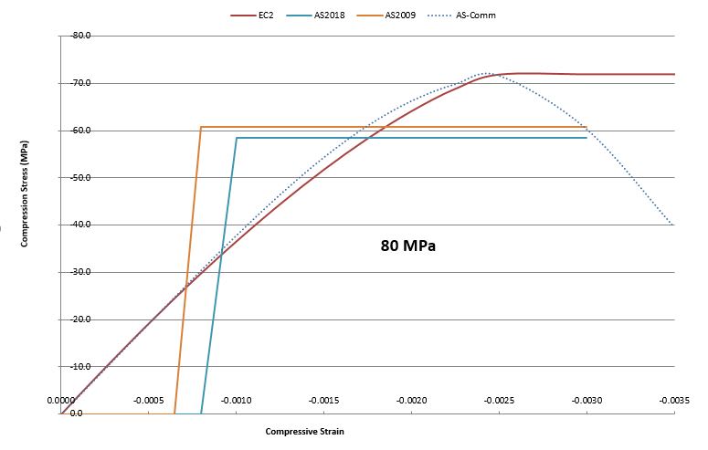

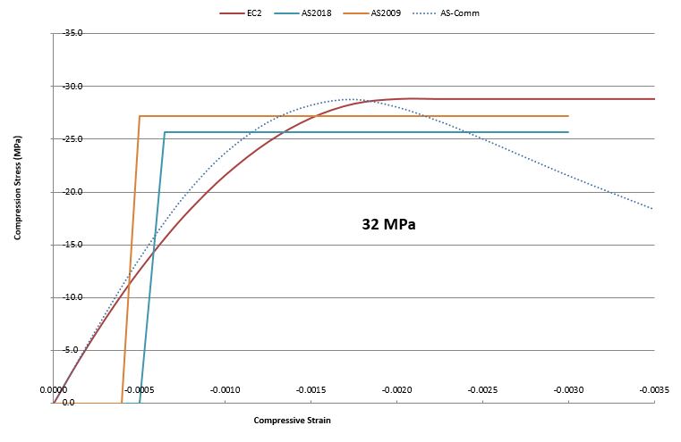

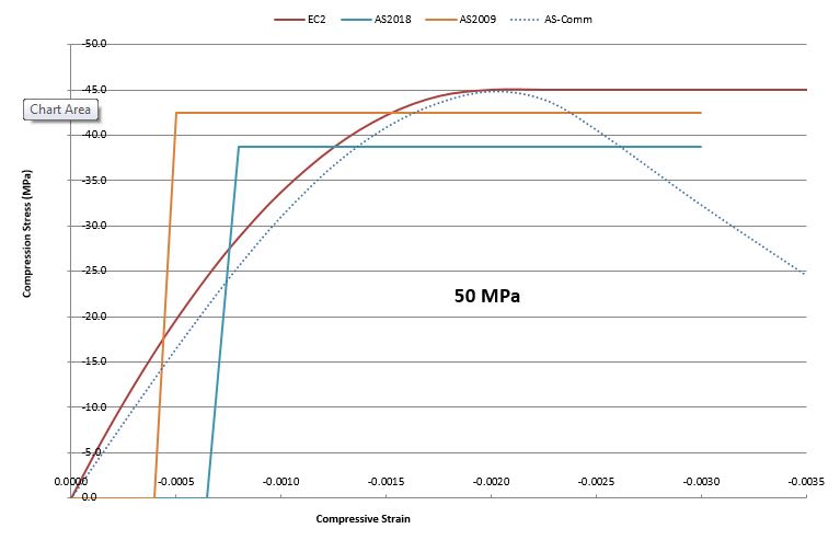

To answer the original question, I use numerical integration (100 slices of cross-section) in a spreadsheet to handle the parabolic-linear (P-L) curve when necessary.
What is the effect of ignoring the post-peak stress drop when using the P-L relationship? By eye, the AS3600-2018 rectangular blocks look conservative whereas EC2 P-L look unconservative by comparison, though I haven't applied these to cross-sections to check.
Obviously need to specify which rectangular parameters are being used when comparing outcomes as they can vary widely as shown in the images. It doesn't look as though the 10% reduction for narrowing cross-section needs to be applied to 50MPa concrete for example (AS3600-2018; again unchecked).
I don't think it has been mentioned in this thread that the rectangular stress block has a lower peak stress (in AS3600 at least) and a fair chunk of the cross-section has zero stress. These combine to have the P-L stress greater than the rectangular stress over large parts of the cross-section (AS3600-2018). Less so in the past though as can be seen. Rapt, was this your doing?
Should just use triangular distribution for ultra-simplified analysis of high-strength cross-sections. Or no simplification: if you're not capable of a moderately complex calculation, stay in your lane and specify normal-strength concrete.
Steveh49 - Interesting results, but I'm not sure you are really comparing like for like there. I'll discuss further when I've had a closer look.

Yes, clause C3.1.4 for the AS-Comm line.
Do you mean they're not like-for-like because they need to be 'scaled' so the peak design strain is in the same place on the cross section? (ie at the extreme compression fibre). A bit hard to explain what I mean, but say for 32 & 50MPa, 0.003 for rectangular should align with 0.0035 for P-L because they're both at the edge of the cross-section. And 0.003 vs 0.0026 for 80MPa.
Does someone mind posting a screenshot of the derivation of those two 2018 Australian curves? I wasn't able to download the draft when it was available, as for some reason they wanted to charge anyone outside of Australia for it. That commentary one looks pretty funky.
To compare apples with apples in terms of overall shape I have tended to make the curves non dimensional, plotting equivalent stress factor vs equivalent depth factor to see the fundamental difference in the curves. I think due to the differences in the neutral axis depth on real sections with the use of each curve, its actually pretty hard to compare anything but the capacity achieved and resulting reinforcement stresses.
