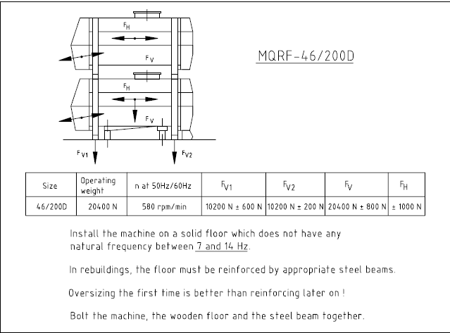

evo10: I noticed that operating frequency is 9.66HZ (580rpm), but still it comes through my natural one. Moreover if they ask for not having 7to12hz, I believe that it is wise to assume that equipment may operate in such range. As you noticed they just added plus minus 2.5HZ (or roughly 25%).
GC_Hopi: thank you for the help. I am probably quite well versed with theory, but practical approach suffers. and here I am looking for some help.
Finally, in reality. I have a force of 1KN (or rather 2kN, since it is shown in 2 locations). It causes also some moment (up and down), but that we see in FV1&FV2. If we just concentrate on values of the force (2kN = 450lbs), I really wonder what is the chance to start the resonance. As GC_Hopi noted, knowing what is a damping constant would help, but it can be a dead end. It is not easy to establish theoretically, and the job itself would not allow on any experimental exercises.

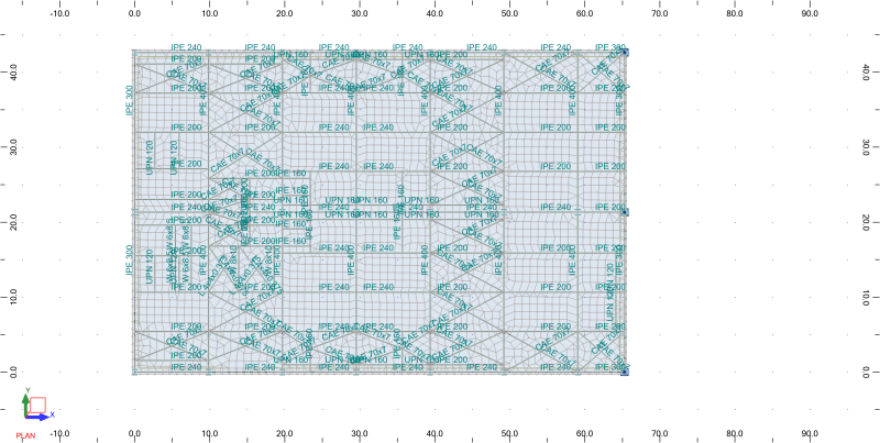

 https://files.engineering.com/getfile.aspx?folder=4e5ca1dd-897e-4c98-8f61-639dc8bb51f8&file=Whole_structure_frequency.PNG

ive never used robot why does it look like you have some pin supports on the outer corners and mid of your cantilever secction XD
It is difficult to see the details on the model;
Have you added the concrete mass into the model?
Did you try to change the stiffness of the beams and add bracing to increase structural stiffness?
You have these two options to change the frequency of the structure.

i would not just add the concrete mass
but account for the stiffness whatever that may be XD
the aisc design guide with vibration, not sure about the acelor mittal, will account for composite beam with decking in the stiffness
but is your deck really composite with the beam
that may have to be taken into consideration in total model
Pins at one end shall not worry you. Do not have good picture, but it is not cantilever, just short span supported (lightly) on precast concrete walls. This side is almost not loaded. Probably if removed from model, there will be no huge impact.
There is no composite action between deck and beams (no studs). Deck itself was modeled with mm precision, and so is concrete (with weigh, etc).
It seems a typo - the vendor drawing indicates the operating weight is 20400N (20.4kN/4600#).
I wouldn't expect that to be a typo. 800N is fairly hefty recapacitating load. I've seen entire floors shaking away severely and unpleasantly from undamped reciprocating loads loads of half that value. Same type of machine a vibratory sifter/screener.
The horizontal loads are 2kN (2x1000N).

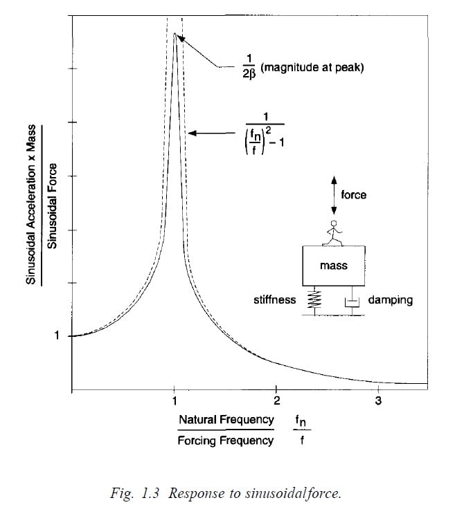

i cant say that equipment operates in the range it may change frequency if say some unbalancing occurs?
here is an illustration of the reason for the range
