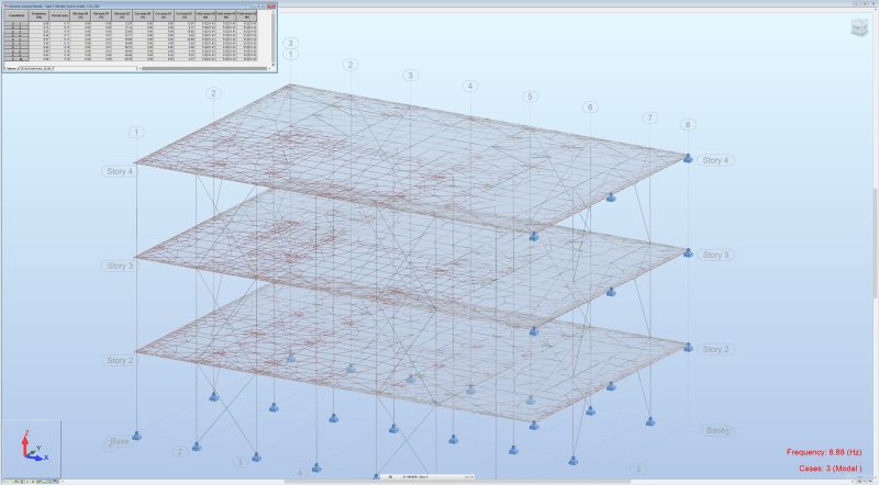

Good morning,
I am looking for a piece of advise how to solve the issue when placing industrial equipment on an existing steel structure.
In details: 4sty existing steel frame (columns, beams + metal deck w/concrete) carries currently some flour mill equipment (old, mostly to be replaced). Some units of the new equipment to be placed on the top floor (can not on ground) have an operating frequency between 7-14HZ, whereas it seems that structure natural frequency is close to 8.5HZ. As per manufacturer, I can not provide dampers in between unit and my floor - however here if someone has any experience to argue this statement, then it would be good.
My first thought is:
- Unit operating weight is roughly 5kips. If I pour a block of additional 15kips, then (since mass is in square root (Sqrt(k/m)->(Sqrt(k/(m+3m))) I may be able to reduce the system output frequency twice to 3.5-7HZ. Or maybe it does not work that way, and concrete block would gladly transfer 14HZ from equipment to my deck without damping it (that would be against newton laws probably, but just want to assure myself).
I probably can someone support this weight on the current structure or reinforce as necessary. But at the same time such block would reduce my natural frequency of whole structure (but that would be just a fraction of whole weight). Does this approach make sense?
If someone has any experience - I would appreciate your input!
That seems awfully high for the structure. Is that the local floor area, the entire floor, or the entire structure?

The natural frequency of whole structure is 8.88HZ

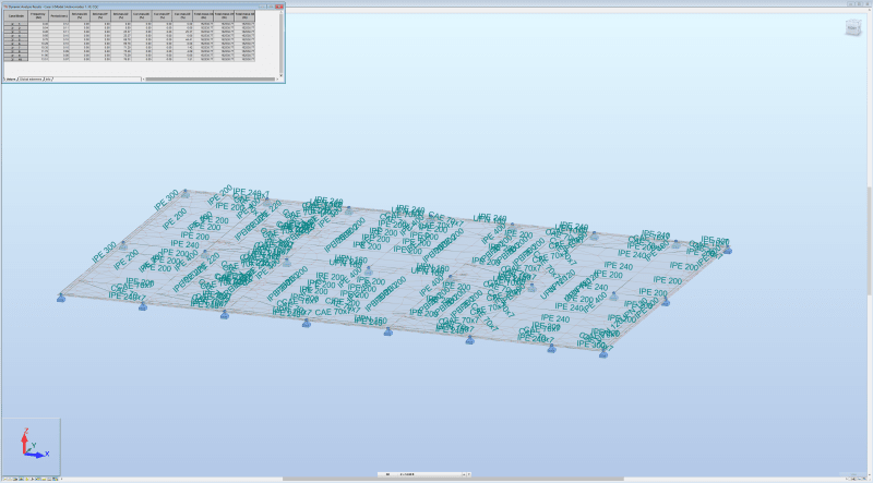

The frequency of the said floor alone is 8.40HZ
when I look on deformed shape (modes) of whole structure (first mode, not visible here) than I see that mostly slabs deformations, whereas columns deformation is much less. Probably I would assume that for the first whole structure mode, mostly slab is responsible. That is probably why the difference between single floor and whole is very small.
marwin23 I think this does deserve further analysis beyond just looking at the natural frequencies. Robot Structural Analysis can perform harmonic analysis with inputted loads, frequencies etc. This really should be your next step.
Also you should start by modeling only the bay(s) where the machinery is rather than the entire floor. Honestly I would still strongly consider stiffening up the bay, this is the most reliable option. Diagonal struts from above or below to halve the effective span length could be an approach. Or talk some experts in the field.
Again, I'd check that figure. That seems very high for the whole structure unless it is an extremely stiff, light building. My reference point is some experience and a simple empirical formulas as given here. Although simplistic the formula do match up with most structures quite well. So I'd recheck your result. Not that it really matters the first frequency of the entire building is likely closer to 3hz so you are well under.

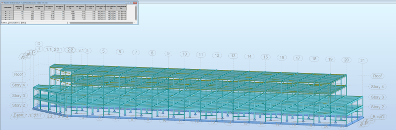

marwin23 formulas like that are used structural codes as a crude way of working out the period. They are sufficiently accurate for most building types to be codified, it is used in the AS code for example. I only presented it because it is the only tool that I have because I don't have any details of your building apart from an estimation of the height. I have doubts that that your mill has a fundamental frequency of 8.88hz. 2-3hz is more likely. I will trust good dynamic analysis over a rough formula any day. But I have my doubts about your Robot dynamic analysis number.
Eg. What are those restrained nodes doing at the far right of your structure on the 2nd, 3rd and 4th floors. If they are restraints then that is likely the reason for your high value for the whole structure.
Not that this matters much because as I've emphasised what matters is the natural response of the localised floor not the whole structure.
I would at least run a model consists of the concrete floor and the steel beams directly under the equipment. IMO, you should check and minimize the effect on the immediate vicinity instead of the entire building.
Agreed.

Gentlemen,
I went through all your suggestions, and although still do not have final results there are some noteworthy facts:
- I was able to receive the same frequencies for both floor and structure in other software. Roughly speaking numbers are/were ok,
- I changed approach. It is enough to decouple right side of the structure from concrete walls, and natural frequency for whole structure drops to something between 1HZ to 2HZ, and floor frequency is (if I remember correctly) slightly above 7HZ. Probably if I modeled whole structure with concrete walls then my results were more accurate, but currently it is not something I am looking for
- right now will work just on ensuring that the right side can sufficiently cantilever/carry load, and will try to add some mass to reduce natural floor frequency slightly below 7HZ.
