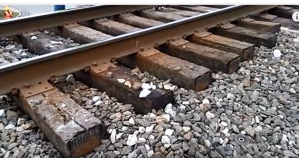

Anyway dodgy baseplate is alive and kicking in Scotland as well. This is under the Christmas market in Edinburgh.
 https://files.engineering.com/getfile.aspx?folder=3847bc9b-e1f0-4d68-977d-ad2d4f8362b4&file=FB_IMG_1572950150940.jpg
Before they re-packed the rails...
I guess this is the maximum they can do without having to dig up the tracks and totally re configure the base below the ballast. Some of the sleepers look like could do with replacing though....

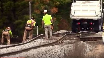

I was stopped at a train crossing on the way in this morning and rather amazed at how much the track flexed up and down with each passing bogie. It had to be moving at least an inch vertically as I was watching it from ~30 feet away. Is that normal?
