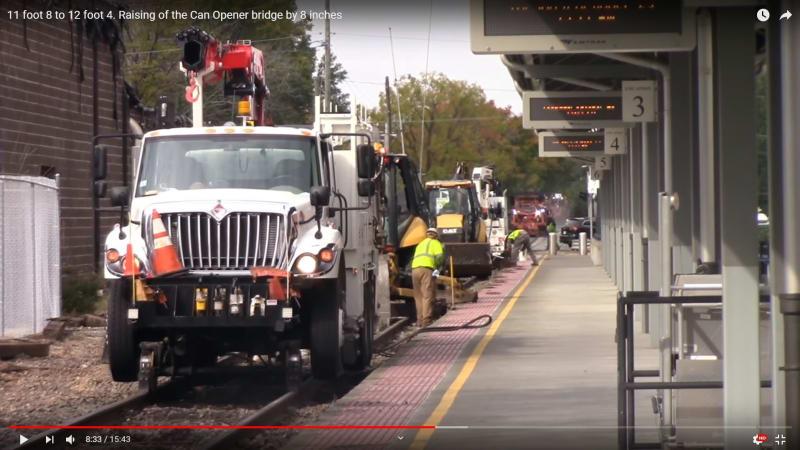

I think 500 tons is way off though. The previous estimate was about 20 which seems low, but there isn't that much to that bridge. It's only 25m of single track railway supported by a few C section beams. If it was total of 100 tons I would be surprised.
I was going off one that was removed north of Aberdeen on the Peterhead road. It was less width and 250 tons.
I also have zero clue what the APN of USA roads is, Or if the pavements are the same.
Getting the load pressure down to the legal max of a road vehicle seems sensible to me. Especially when all it requires is the temporary laying down of some plate. Which is pretty standard for mobile cranes. And even then they sometimes kill the surface.
That pressure is way under what a woman's high heel puts down. Maybe keep them off the apron as well?
I did look for ways that I missed major contributors to weight, but it's clearly pairs of c-channels, one under each rail and rail companies seem unlikely to overspend. A current heavy locomotive, which should weigh a good deal more than any rail car so it should be the upper limit, is about 400 kips. It's weight is split to at least 2 trucks, so the concentrated load is just 200kips and the beam is not a single free span.
No links to that narrower, heavier bridge? This bridge's superstructure isn't as wide as the ties; getting narrower is footpath territory.
Yes - mobile cranes can do damage. Because the heavy ones put down more load than a locomotive. But this isn't a mobile crane or the higher loads that other mobile machinery can put down.
Edit - The 20 kips is per beam. The bridge has 2 beams, so twice that amount for the entire bridge. Of course it is then divided among twice the number of jacks and scaffolds, so back to the original loading.
Ahhh too bad about the ads in the video. I use the AdBlocker extension for Chrome and didn't see them. It works almost all the time.
Edit: This video screenshot shows them working at the train station which is about 600 feet way. I suppose there wasn't much they could do about the grade without it becoming a bigger project. Also I sounds like the job was supposed to be finished in less than a day so the train schedule would not be interrupted.

Are those trucks commonplace / a standard design?
