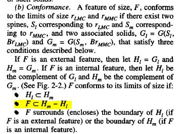

Perfect form is not technically required per rule #1, however a sphere is a special case due to the swept spheres definition of size. Neither a sphere of MMC size nor a sphere of LMC size may be violated. The secondary effect of this is that perfect form is technically required at both MMC and LMC for a sphere.
By definition, perfect form at LMC is not required, so there is no "LMC sphere" it's enough to have "LMC measurements" which are all 8mm.

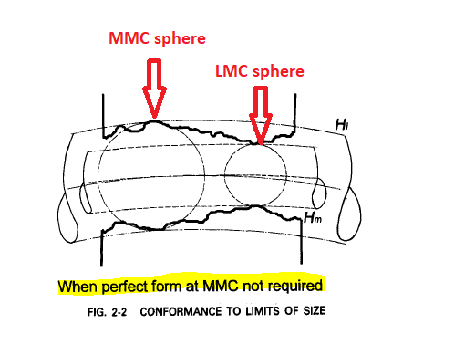

For a spherical feature, the limits of size dictate that the as-produced feature must exist in the volume between the two solids G(S[sub]l[/sub],Br[sub]LMC[/sub]) and G(S[sub]m[/sub],Br[sub]MMC[/sub]) where S[sub]l[/sub] and S[sub]m[/sub] are 0 dimensional spines (points). The effect is that which I described above. Neither a sphere of size MMC or size LMC may be violated.

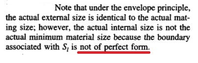

chez311,
You have to read same standard but little further, actually next paragraph.
No LMC sphere still.

That statement is an extrapolation of the fact that for a feature controlled at MMC, S[sub]l[/sub] is not required to be of perfect form. For a cylindrical and width shaped features having 1 and 2 dimensional spines respectively means that S[sub]l[/sub] is not required to be a line or plane. There is still an LMC sphere swept in both cases, even though perfect form is not required. No allowances for a different interpretation for spheres is provided even though the term imperfect form does not make sense for a 0 dimensional spine ie: point as there is no possible form variation of a point, so we must sweep an LMC sphere along a 0 dimensional spine (point) which results in a single sphere of LMC size.

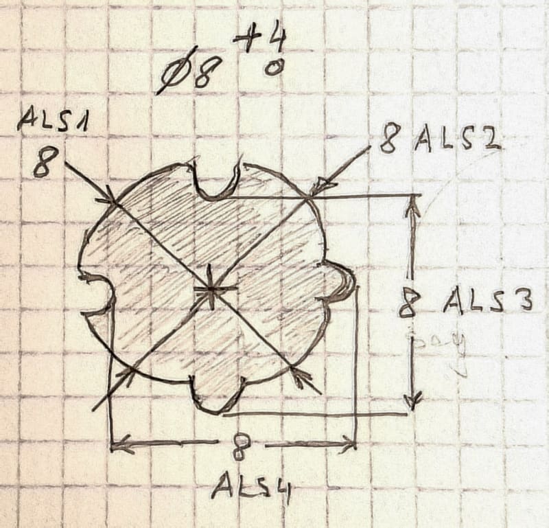

The same would also apply to a circular feature of size. Can you please show me a circle made at its LMC (dia 8) and that is imperfect?
Tarator, see the graphic above. It illustrated an as-produced feature designed nominally circular.
Every actual local size on the circular element (could be a cross-section through the center of a sphere) is exactly 8mm and not less. Purely per the Y14.5 meaning of limits of size (Actual Local Size) the feature is within spec. It is measured as distances between opposed points. This is also how the majority of the industry works.
Some will point again towards Y14.5.1 and say that the swept spheres concept is the final word. But the discrepancies between the standards are the problems of the committee, not the user's fault. It is also not that important that the definition of actual local size is somewhat incomplete - two point measurements are a well-established concept in the industry.
Burunduk,
That's a great sketch actually. Thank you!
I am in favor of 2-point measurements for actual local size measurements. So that would make the IB 4 then, not 8, which would be consistant with all the features of size.
Tarator, no problem. Glad to provide any useful insight. 4 as the IB is also my suggestion but it is still somewhat controversial from the reasons mentioned in the different posts in this thread; namely the absence of the implied rule #1 form error allowance from the Inner Boundary definition that in the 09' version only mentions "stated" geometrical tolerances as factors added to the size tolerance to generate the boundary, and the other thing is the swept spheres concept.
Burunduk,
I see the definition of IB can cause hesitation. Let's call it the Smallest Worst-Case Boundary... My intention is to be able to use it in a tolerance stack-up analysis for a min. wall thickness problem for example. What the name is would not matter much.
Then I say 4mm is the right boundary if size limits are to be evaluated per the ALS definition.[thumbsup2]
