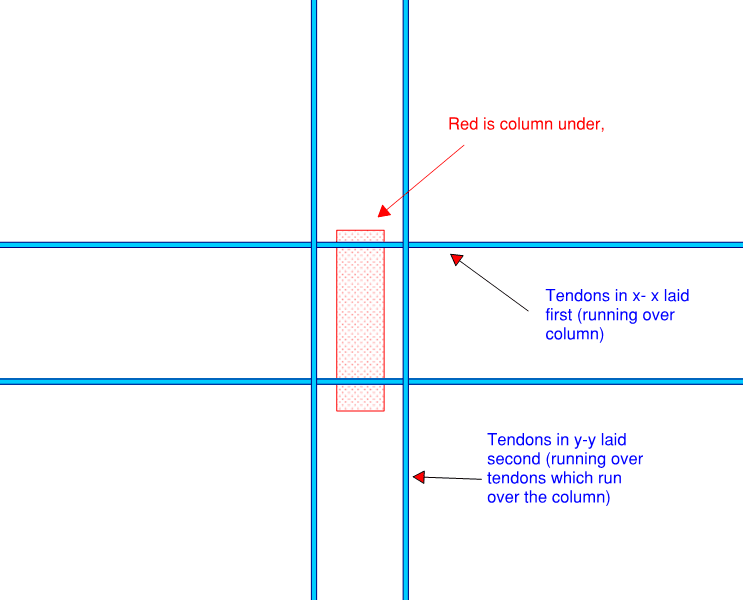

I believe I understand the intent of this clause. Consider the following situation
In the attached image, Looking at the Canadian code it allows for the use of tendons (13.10.6.3). If the tendons in the X-X (directly over the column ill get to this bit next) have sufficient As.m to carry the load then how will the failure occur? If you get significant load reversal or something major happening and we get a full connection failure the tendons over the column will pick up the tendons close to the columns in the Y- Y direction (on the bases they have the correct As min)
Secondly with regards to this "zone" where the reinforcement needs to be I have never seen a straight failure of any structure directly vertical at the column face. Is there any examples of this, why is it not column dimension + D (slab depth) each side?

Think I can help with a few of your points
The reasoning for this is that the bottom integrity bars will tear out from the failure cone if they have nothing to bear on (like the horizontal face of the column)

AR, with regards to the zone, I agree in the RC solution of bottom bars, but in PT if you had a tendon with a high point right next to the column then it wont tear out.

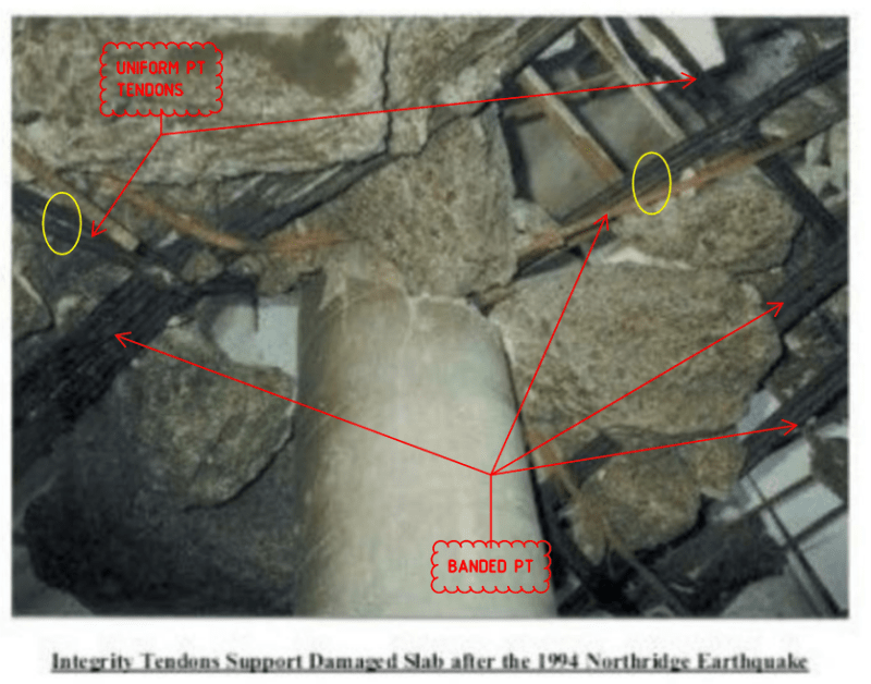

The following photo is not from a Mexico earthquake (1985 nor 2017) but it is a slab soffit photo post-Northridge (California) earthquake of 1994.
Unbonded PT flat plate - typical USA practice of banded/uniform tendon placement.
Yellow circled tendons are those placed directly over the column core.
Not a pretty picture - but it worked. Not much concrete with significant capacity around the column face.

The photo provided above by Ingenuity is actual proof behind this concept that it works and is achieving the intent of the clause.
