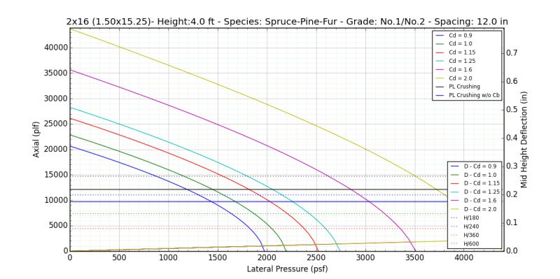

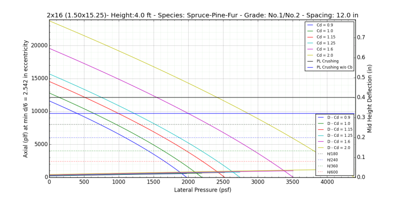

So I decided that I no longer wanted to be beholden to Woodworks etc and I would make my own stud wall MathCAD sheet. Go me. I wanted it done differently than what I see most folks do though. I wanted to generate interaction diagrams so that, for given project, I could just generate the diagrams for the handful of wall types that I'll use and then pick values from the graphs as needed. The graphs below do this I think. Each line is a different duration factor (0.9,1,1.25,1.6). They are for 2x4 stud grade 92.625" long; wind (psf) on the x-axis and axial (plf) on the y-ais. I've attached a printout of the entire worksheet for the ambitious.
I've spot checked some results and they seem to be okay. What's bothering me is how straight these curves are. The only action is at the top left in the first diagram where things get curvy with low levels of wind pressure. If you include minimum axial eccentricity of d/6 like software often does, even that goes away. That's what's shown in the second graph below.
So my question is this: does anybody have enough experience with wood stud wall interaction diagrams that they could confirm or deny if the results I'm getting look nuts. Considering how straight the lines are, I would have thought that NDS would just simplify the equations to suit. Frankly, if it's this linear, I feel pretty silly for even going to the trouble of making this spreadsheet.

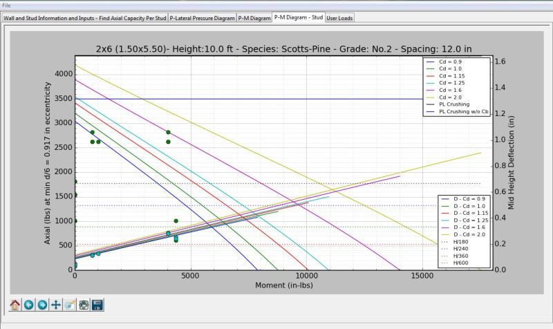

made a bunch of additions the output now includes capacities at various stud spacings, added a P-M curve which is nearly identical to the P-Pressure Curve with the exception that it plots mid height deflection inclusive of the eccentric moment.
See it in Action: full res animated gif
Common Capacities:

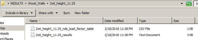

added the ability to export the results as a text file.
Gives you two files a CSV file of the NDS load reduction factor table and a pure text file of the results text box
Everything is saved on your desktop in a 'RESULTS' folder
Compiled File: OneDrive
source code is on my github - linked in my signature

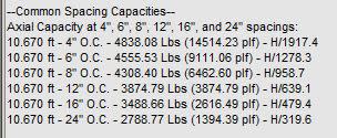

-Automatic generation of PvPressure, and PvM curves for common spacing's of 4",6",8",12",16", and 24". Charts are saved as 11x17 pdfs in the results folder

Think Appendix H is shedding some light on the behavior:
using my 2x16 stud at 12 in as an example - stresses below assume 20 psf and Cd=1.6:
no eccentricity
4ft tall:
Code:
fc = P/A = 1552.830 psi
fv = VQ/Ib = 3V/2bd = 2.623 psi
fb = Mc/I = M/s = 6M/bd^2 = 8.256 psi
Combined Axial+Bending:
[fc/Fc]'^2 + fb / Fb' [ 1- (fc / FcE)] = 1.000 <= 1.0
Ke * le,d / d = 3.148 in < 50
very low bending stress relative to axial stress therefore squared term of combined check controls - short column
30ft tall:
Code:
fc = P/A = 386.944 psi
fv = VQ/Ib = 3V/2bd = 19.672 psi
fb = Mc/I = M/s = 6M/bd^2 = 464.391 psi
Ke * le,d / d = 23.607 in < 50
Intermediate column

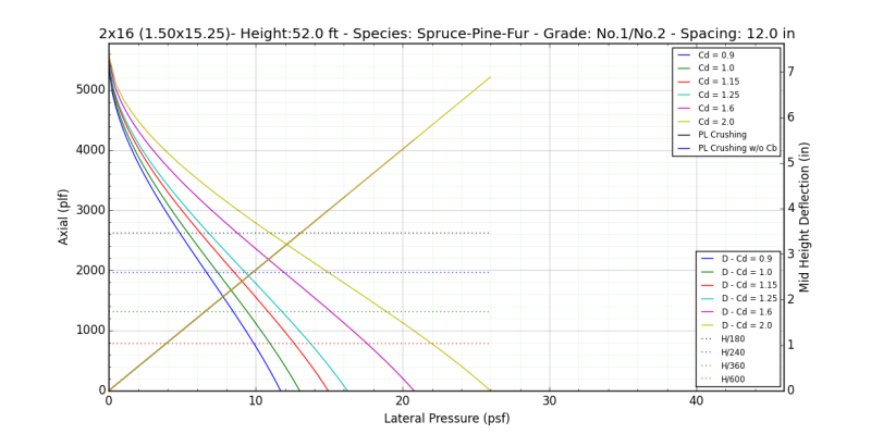

52ft tall:
Code:
fc = P/A = 8.959 psi
fv = VQ/Ib = 3V/2bd = 34.098 psi
fb = Mc/I = M/s = 6M/bd^2 = 1395.238 psi
Ke * le,d / d = 40.918 in < 50
Bending Controlled - non-squared term of combined check governs
now looking at the 4ft tall wall again with d/6 eccentricity:
Code:
Pmax,allow = 19464.43 lbs (19464.43 plf)  at min d/6 = 2.542 in eccentricity
--Applied Loads--
Pressure: 20.00 psf x Spacing x 1 ft / 12 in = 20.00 plf
Lateral Shear: 40.00 lbs + Gravity Shear: 1030.67 lbs = Total Shear: 1070.67 lbs
Lateral Moment: 480.00 in-lbs + Gravity Moment: 49472.09 in-lbs = Total Moment: 49952.09 in-lbs
Lateral Delta: 0.000 in + Gravity Delta: 0.011 in = Delta: 0.012 in - H / 4115.3
--Stresses--
fc = P/A = 850.904 psi
fv = VQ/Ib = 3V/2bd = 70.208 psi
fb,lat = Mc/I = M/s = 6M/bd^2 = 8.256 psi + fb,gravity = 850.904 = 859.160
Combined Axial+Bending w/ Eccentricity:
[fc/Fc]'^2 + (fb,lat + fc(6e/d)[1 + 0.234 (fc / FcE)])/ Fb' [ 1- (fc / FcE)] = 1.000 <= 1.0
fb >> fb,no ecc. non-squared term in combined equation begins to govern much sooner if not immediately

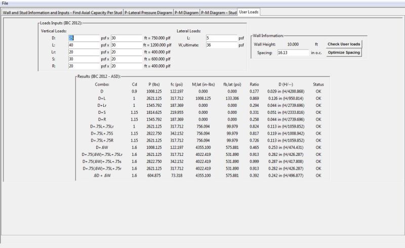

user loads and IBC 2012 load combinations implemented and also added ability to optimize stud spacing for user loads. Use loads are plotted on the PvM-stud curve.
User Loads Tab:
PvM-Stud Tab:

-User Loads - Interaction ratio corrected to be checked against fc/Fc' when M=0 and fb/Fb' when P=0 for case when min. eccentricity is not included.
a current base assumption is fv/Fv' won't control but I'm going to add that check in just as a catch all. plan to update the ratio text to indicate what NDS equation it checked against/controlled to make manual back checks easier. So next update the ratio text will read something like
