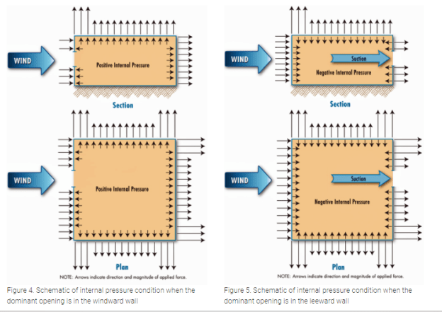

Internal pressure (i.e., building pressurization/depressurization). Wind striking a building can cause either an increase in the pressure within the building (i.e., positive pressure), or it can cause a decrease in the pressure (i.e., negative pressure). Internal pressure changes occur because of the porosity of the building envelope. Porosity is caused by openings around doors and window frames, and by air infiltration through walls that are not absolutely airtight. A door or window left in the open position also contributes to porosity.
Wind striking an exterior wall exerts a positive pressure on the wall, which forces air through openings and into the interior of the building (this is analogous to blowing up a balloon). At the same time the windward wall is receiving positive pressure, the side and rear walls are receiving negative (suction) pressure; therefore, air within the building is being pulled out at openings in these other walls. As a result, if the porosity of the windward wall is greater than the combined porosity of the side and rear walls, the interior of the building is pressurized. But if the porosity of the windward wall is less than the combined porosity of the side and rear walls, the interior of the building is depressurized (this is analogous to letting air out of a balloon).
When a building is pressurized, the internal pressure pushes up on the roof. This push from below the roof is combined with the suction above the roof, resulting in an increased wind load on the roof. The internal pressure also pushes on the side and rear walls. This outward push is combined with the suction on the exterior side of these walls. Therefore, a pressurized building increases the wind load on the side and rear walls (see Figure 4) as well as on the roof.

Besides the code, a review on internal pressure due to fluid medium on enclosed space may help.
R13 what does that even mean? Are you suggesting a cfd analysis is required?
If you are suggesting such on a standard building then I think a sledgehammer on a nail comes to mind.
"Programming today is a race between software engineers striving to build bigger and better idiot-proof programs, and the Universe trying to produce bigger and better idiots. So far, the Universe is winning."
Physics is something we experiences daily. For this matter, blow air into a balloon and image the pressure on the enclosure is the most simple example at your finger tip without the need for a hammer. Sure, you can use one, if you want to complicate it with air dynamics, drags..., which could be implied by the code by coefficients.
I don't think a practicing engineer is going to get great results on the CPI coefficient from visualisation of air flows from a balloon. All I get is that the CPI should be equal to cpe to create a static dynamic, however I don't think that houses behaviour is similar. The code that he is using handles the problem as stated, it isn't difficult, no need to be using some abstract concept that is clear as mud to solve.

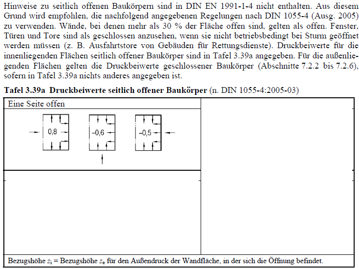

What I found lately is part (chapter) of a German publication with some additional explanations and guidelines for may case (building completely open on one side and totally closed on three sides).
The author pointes out that assumed internal pressure cpi can be as mentioned in "old" DIN 1055-4:2005-03...print screen below:
