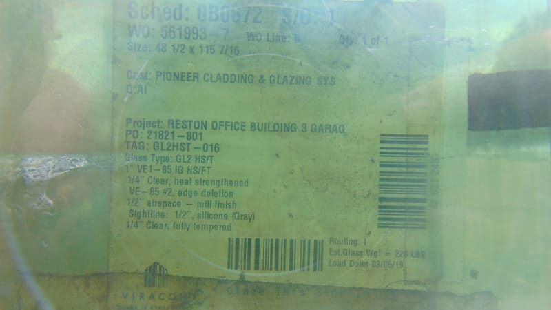

Thank you jj317. You gave me the confirmation I was needing. His specific question was if there were any governing code issues surrounding the installation. To answer your question, these are engineered panels with an internal frame but based on the manufactures' information, these panels could be wet or dry glazed or use a mechanical fastening system.

Manufactures' sticker for reference below.
My first statement was that I thought you needed an engineer familiar with cladding and glazing design, who could then advise on any relevant code related issues.
Based on your responses, I am not sure we are on the same page at all. I don't know anything about the MEP provisions in the IRC / IBC, but for the structural, my interpretation is basically that either you are following the prescriptive guidance in these codes (which would not necessarily require an engineer to review) or you need an engineer to verify the assembly/design.
For example, who is going to verify that the "internal frame" is adequate structurally to resist the imposed loads? Or that the glass itself is adequate?
Based on the sticker, I presume that these are unitized curtainwall (or window-wall) assemblies provided by Pioneer Cladding. While it is completely unclear how you friend ended up with these units, I would think that contacting Pioneer about them might be appropriate. I would expect that they had hired an outside engineer to design them originally, and this engineer should be able to help you in confirming whether they would be appropriate for this alternate use.
