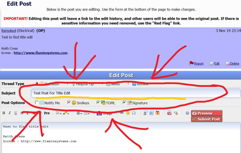

Mbrooke; If there is still time how about you correctly spell "burying" in the title? Bottom right corner, hit EDIT and fix it. Otherwise a year from now this thread gets really hard to find because people search for it with the correct spelling.

Edit: I can't edit the original title.

The next option is to red flag one of your posts and ask the moderator to edit your title. And this one, and Keith's.

There is no edit button present anymore in the first post. I think that it would be obvious, that at some point the edit feature expires.

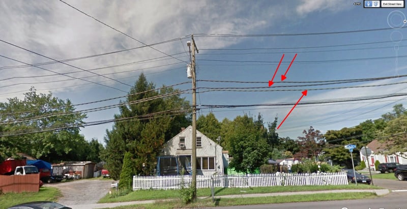

@waross: I think underground could be really cheapened. Whats to stop 3 single conductors cables on the main road and one single conductor down the side streets?

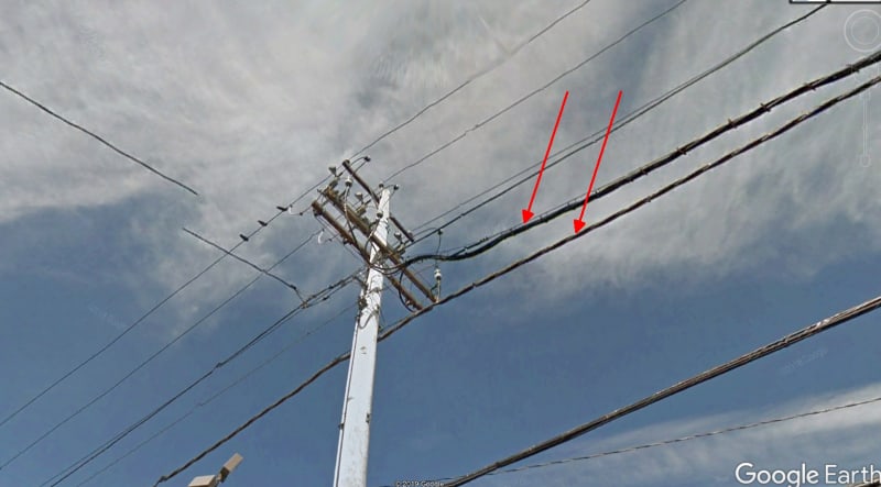

I know Con Edison and United illuminating will run aerial bundle for miles on an overhead circuit. What difference would it make if buried?

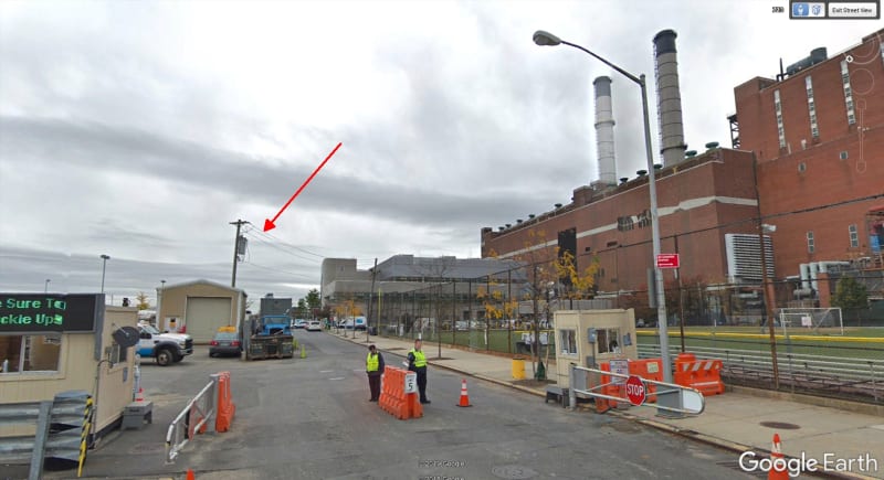

Well, I beg to differ [tongue] [jester]
On East 16th st there is a small stretch of overhead line behind the East 13th st generating plant.
Mbrooke; All of the cables that are identified by the red arrows are messenger cables for insulated power conductors, telephone and or cable TV.
As for three buried singe conductors, That will cause impedance matching issues, and excessive reactive voltage drop.

@Waross: they are 15kv cables. This I know for a fact and hence why I included picture #2 and 3 where the cables transition over to a gang switch and then bare wire. Con ED and UI do this all the time. They will run several MV ABC cables (from the substation) going up to 8 miles to feed an area. Its an elegant approach to getting more MWs out of a wooden pole and more reliable. Often when a tree takes down the bare wires the bundle keeps power on for the other circuits down stream. If it can be done overhead why not underground?
