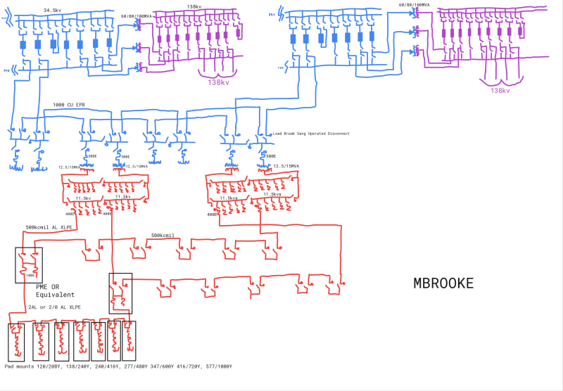

@Bacon4Life: This is what I came up with:
I'm thinking of not having a 400/600 amp backbone with PME/FPE gear. Just 200 amp fused feeders from the intermediate substation looping through padmount units. Load breaks and fuses at the supply stations to curb cost.

I don't quite understand the picture versus your comments. There seems to be 500 kcmil AL feeding from the 11 kV substation out to PME gear. This is the portion I usually think of as the backbone.
We have some feeders limited to about 200A at 12 kV, and a typical commercial building is 50A. Since only a few buildings fit on each baby feeder, adding just one large building can require either an entirely new feeder, or moving several loads to different feeders to keep them all feeders below thermal limits.
Interesting thoughts about removing field fuses and changing from substation breakers to fuses. If the system is entirely underground, the fast restoration ability of breakers would be used less often than a system with mixed overhead/underground. Since fuses have to be replaced after a fault, one would have to examine the impact on restoration times for having to replace substation fuses after every fault. In addition to the crew that isolates/repairs a fault, you would also need an additional crew at the substation replacing the fuses in order to provide fast restoration. There seems to be lots of buzz about flisr, and add moving from breakers to fuses seems like the opposite direction.
Correct, in a typical system there is / would be a backbone.
Correct, but in existing installations that would be planned in advance.
The way I see it is cost. Fuses are cheaper as whole, especially when you have an intermediate substation.
I am torn between this approach and just running 34.5kv to everything. The issue is that 34.5kv has far more reactance.
