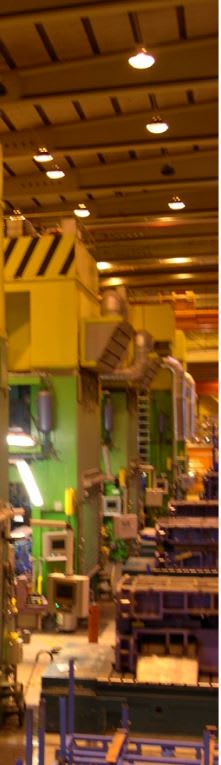

The yellow part at the topp is the hydraulic tank 6 m3 oil, that is 7 meters above floor level, then there is 3 meters in the celler too.

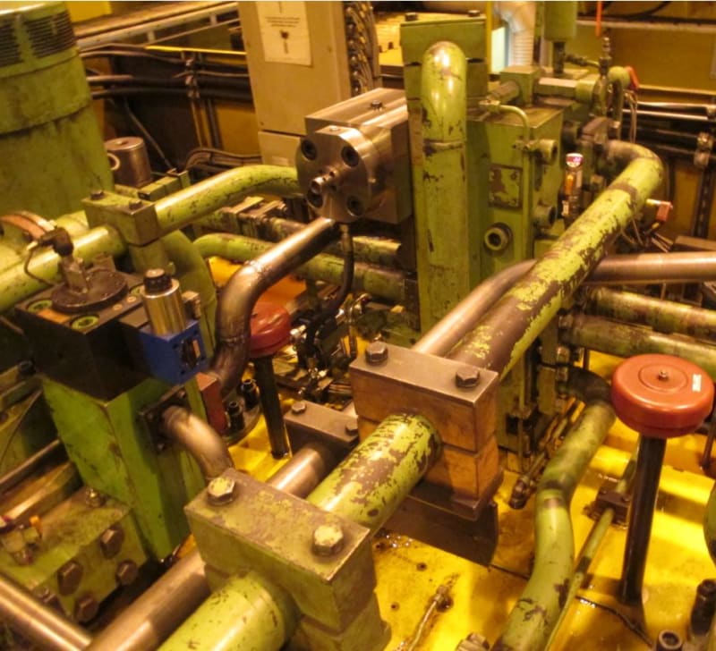

Just to give you a better picture this is the main pump system on the smallest machine on top of the tank.
