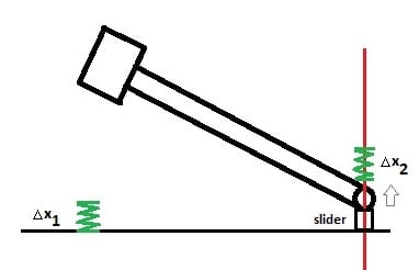

Thank you, to determine reactive forces, what I need to do is setup a pendulum hammer where the end the hammer (handle side) rotates but is also suspended on a spring, then let the hammer swing and drop against the ground, the ground also has a spring on it and measure how much the hammer end compresses the suspended spring and how much the hammer heavy side compresses the spring on the ground, EDIT: kind of like this:
This is my guess on how I would go about checking the reactive forces. Can I hypothesize the spring on the ground and the suspended spring on the hammer handle end will compress the same amount?
Also is this considered a closed system?

You are hoping that this will work as it will function as an open system. An open system requires there to be another chunk of mass hanging around somewhere that this momentum can be transferred to/from.
This is a closed system, the unsprung suspension goes down and the rest of the car goes up. Its not open because there is no spring or stack of bricks hanging out above the car that you can con this equal and opposite force off on. Early on in the thread you show this system being attached to an arm that's attached to the chassis. That's it, your force is going to the chassis and thus the rest of the car. There is nowhere else for this impulse to go.
It is external if there is a person standing on the track with the jackhammer ready to hit the suspension as the car goes by. It is internal if the jackhammer remains attached to the car.
L.Bostock & S.Chandler is saying the fixed surface is of infinite mass so changing the momentum of the fixed surface is impossible. That is not the case for any part of a car. When you jump up, the planet moves away, just a tiny and non-zero amount.
The "fixed surface" is fixed and cannot independently apply any force, it can only react to some input force. If a particle hits a fixed surface, the force applied by the particle impulse is f=m×v/t .

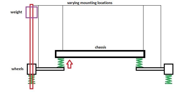

I had a followup, so I setup a rig kind of like my leg press, and varied the location where I want to mount my so called jack hammer, basically right near the unsprung part of the suspension seemed the best.
What I noticed the rebound of only 25%, so basically the chassis moved up.
So from here, if I had a 600 lb static load, and the rebound was 200 lbs, could I assume we have net load on the unsprung tire by 400 lbs or am I missing here?
Secondly, I'm assuming jack hammers have some built in spring to reduce the rebound.
Also, rebound or lifting of the chassis isn't that bad, if I take that 200 lbs of rebound and send it to the rear of the vehicle, to uncompress the rear of the car, so the load will return to the front, basically interlinking it with say a 1:1 hydraulic circuit.
Can someone clear this up? I believed I would get 600lbs of rebound into the chassis but it doesn't appear that way, what do I need to fix?
You still have not bothered to understand how a jackhammer works. You have read in some specs that it has a "rating" of 600 lbs force and are making simplistic assumptions of what that means. The average force that the hammer provides is limited to its weight. It can provide moments of higher peak force during the impact. The stiffer the object being hit, the higher the impact force, and the shorter the impact duration. A soft pneumatic tire will average all the impacts to be equal to the weight of the hammer.
Right now to make things simple, I’m assuming the tire is infinitely stiff. And even it the tire was soft, the blow should provide some extra load on the tire which is what I want.
If the only force the hammer can provide is the weight of the Jack hammer, say 35 lbs, then whats the point of the having a Jack hammer.

Even if you did get some sort of meaningful downward force, the tire is going to rebound right back up with some force component of whatever you pushed it down with.
So taking this, and from my observation, the rebound was only 25% into the chassis, my wheel was solid, and the chassis only showed a 25% upward force, but the downward force from the weight was a lot more, so I'm thinking either my experiment is wrong or if anyone can clear up why the chassis only rebounded 25% of the load I put on the wheel which was impacted by the weight I dropped on it.
I'm picturing a trampoline type of scenario, where the initial height of the person will be far greater than the rebound height the jumper achieves. The trampoline takes or like you all stated absorbs the force, but what is that force in my scenario like the trampoline. And what is the rebound force.
In addition, assuming the concrete was very hard, if I go by the fact a jack hammer load per blow is 600 lbs that means 600 lbs is getting returned to the operator, correct? Or do manufacturers build something in jack hammers to reduce the rebound? maybe some springs?
