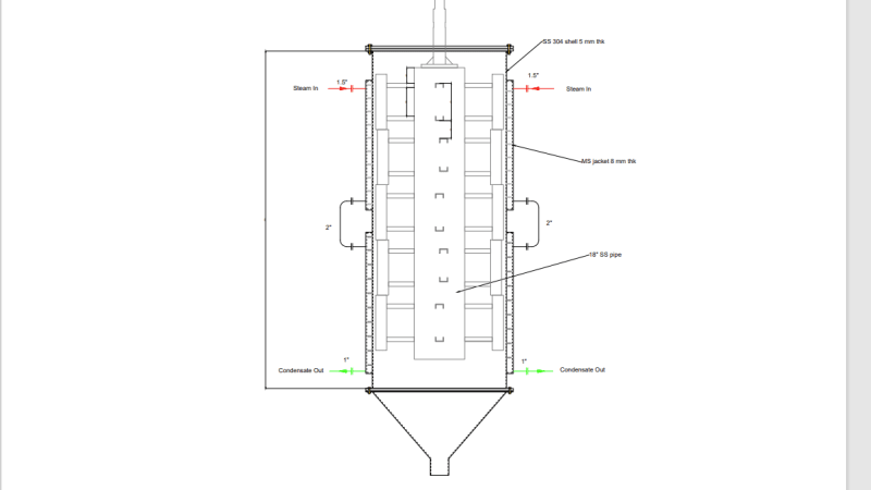

We have a jacket heated agitated thin film dryer in our plant . 6 months ago it bulged on the inside. We fabricated a new vessel and after running for 6 months, it again got damaged by bulging on the inside on 6 locations like a flower. What might be the reason for this? This vessel is empty on the inside with blades scraping the inside of the shell and outside it is jacketed and heated by 2 bar steam through spiral baffles. Please tell me your thoughts about possible reasons behind this? Is the thickness sufficient. Please tell me how to calculate the thickness for external pressure. I got stuck on the unsupported length since it is stiffened by spiral baffles.
Basic data is SS 304 5mm thick shell, #I thought we had dimensions but it doesn't look like it at present only this. Picture makes it look like 600 to 800mm diam

LittleInch, Shell dimensions are 1200 mm ID x 3000 mm Height x 5 mm thick SS 304 material with circumferential weld at middle. Top jacket height is 1180 mm, bottom jacket height is 1280 mm. Jacket is 8 mm thick MS plate. Top jacket starts at 260 mm from top. Length between two jackets is 200 mm. Jacket ID is 1320 mm. Spiral baffles are 8 mm thick 40 mm wide stitch welded MS strips of pitch 120 mm. Steam pressure inside the jacket is 2-3 bar max. I don't think internal pressure in shell could go to complete vaccume since at bottom there is a 6" opening for salt to fall.

But 1.2m diam at only 5mm thick is pretty thin for what could easily be 2.5 to 3 bar DP.
That's a D/t of 240.
stitch welded strips offer very little reinforcement so forget about them.
The jacket's closures act as reinforcement. But we don't have the drawing.

going through all the posts, I don't think the vessel was properly designed for 2-3 bar external load. This coupled with the gravity load plus some extra external pressure load due to condensate head may have caused the bucking of the bottom part of the vessel.
It's logical to think why the buckling is towards the inside of the vessel, not outside. I would have guessed that the buckling could also have been outward as the condensate would pull some vacuum when the jacket operation is stopped.
Another thought that comes to my mind is that it will take an appreciable jacket force to detach the welded baffle plates from the vessel wall. Is there, any instance that the MP steam PRV saw some excursion? I have assumed MP steam as your working jacket pressure is 3-4 bar.

Guys, I've attached the drawing file for the vessel, we dismantled the shell and found that the top side shell also got bulged inward but not more than the bottom one. PRS is set for 2.5 bar. You're saying it's too thin, but the old one worked for almost 7 years and the new one lasted for 6 months.

Edstainless, i already mentioned that a maintenance activity was done on the PRV while this machine was running. The PRS is in another plant, from there they have this one line that goes to this vessel in different plant. We're thinking the maintenance person might've opened the bypass for more than 2.5 bar while working on the said PRV.
GD2, This new vessel is just a replicate of the old vessel, nothing's changed, contractor made this vessel same as the previous one. Also I don't have any data for the old vessel.

The problem is that you, as the operator, seemingly have no idea what the design pressure is for the steam jacket, what the vessel design code was or what the FoS is for the vessel to prevent collapse. Also not sure how you have a steam system entering a jacket with seemingly no pressure relief on it. You are probably correct that the technician did some sort of bodge to keep production going whilst he did something to the main pressure valve and over pressurised the jacket, but now won't admit it once the tank went bang.
So maybe the original design was for a lower steam pressure? How do you know if you have no contact with the designer?
You've had a vessel collapse which is potentially very serious. the jacket could equally well have failed and injured someone or done more damage, so you really need to see how and why this happened to prevent it happening again.
Virtually everyone here is telling you your vessel imploded due to excessive differential pressure greater than the design case, but now it seems you don't actually know what the design case was.
Also re-reading your OP it says your first vessel failed 6 months ago (after a few yeas of operation) and then you built an identical one and it failed also after 6 months. Does something not strike you as a bit odd there?
