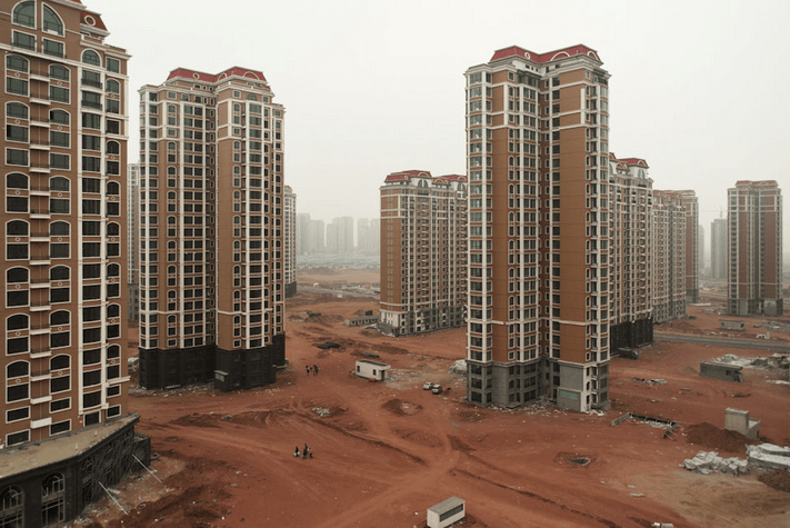

Just Some Nerd, I don't believe that at all. In fact, here is a picture of long-term city planning - build and they will come - in the guise of cookie-cutter apartment houses. In the long run it led to the original post.

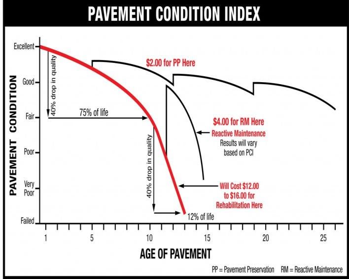

This deterioration curve is for pavement, but a lot of other infrastructure would be similar. Proper preventive and corrective maintenance will prolong the lifespans of most facilities. The keys are planning it and funding it so you can stay near the top of the curve for as long as possible.
Some funding sources have adverse incentives. They will fund rehab or reconstruction, but not preventive maintenance. For example, the Federal Highway Administration will pay for 80% of a bridge replacement project. Perhaps they should pay for bridge cleaning and painting instead. NY State distributes highway funding to municipalities, but insists it goes to projects with ten year minimum design lives. Preventive maintenance like surface treatments have the lowest lifetime cost, but need to be reapplied more often than that.
And that's why I would take a long look at any candidate that held a ribbon cutting for a crack sealing project.

The red one is like the Winnipeg model. They have done very little or poor maintenance over the decades, and I think it has caught up with them.
@ACtrafficengr - the point I get from that pavement maintenance curve is that roads are designed very poorly, only 13 year expected life span? No wonder I see local roads in a continuous re-build state, starting at one end, getting to the other end in time to start back over. Any idea how much more expensive it would be to say design the road for a 50 year life span, or more, I would expect it would probably be less than lifetime maintenance on asphalt.

@Aesur, That's just a representative graph, and most roads last longer than that. The point is preventive maintenance has a much lower lifecycle cost than deferred maintenance.
Also, the X axis should really be in the number of truck axles crossing it, but that's pretty hard for most people to visualize.
Actual life depends mostly on weather, amount of truck traffic, pavement design, drainage, subsoil type, etc. Like any engineered product, it's a balancing act between initial costs, maintenance costs, and user costs.
