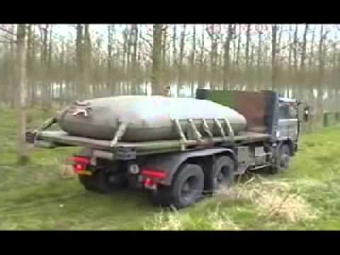

I wonder if the incoming water may be blocked with an inflatable bladder tank. They come in all shapes and sizes.
Bill
