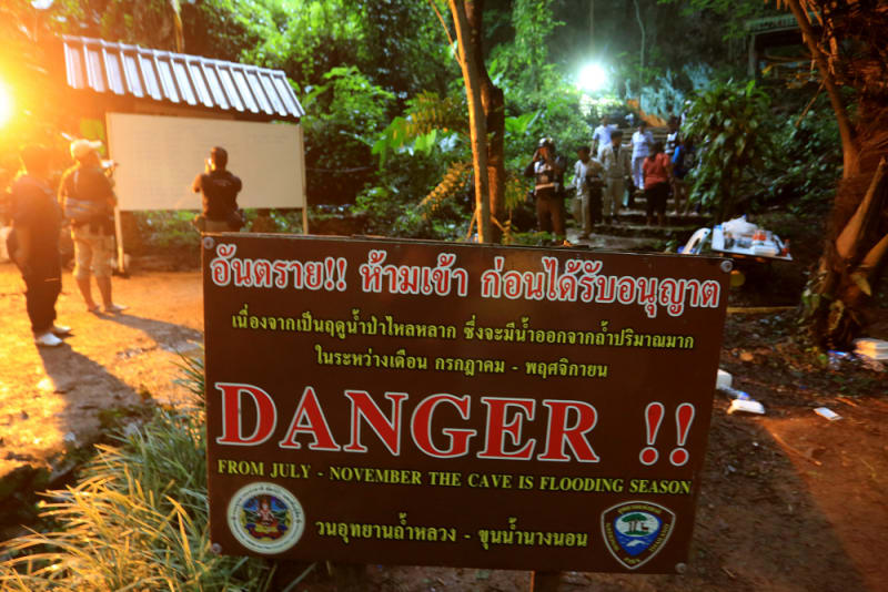

I think more recklessness than bad luck. There were posted signs warning not to go in during the rainy season. I applaud the rescuers, they were doing heroic work even if the kids and especially the coach, were stupid. The real shame is the Thai Navy Seal diver who died.
Technically they entered the cave on June 23. I guess the rains came early this year..
