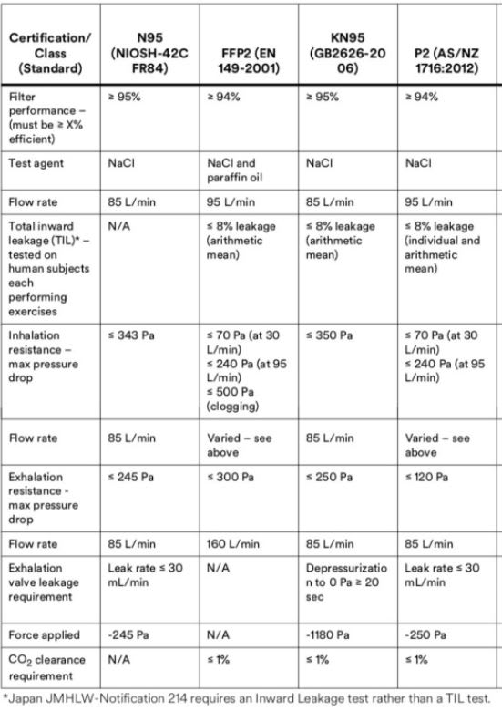

According to this website, there's almost nothing different between N95 and KN95 masks, just the standard by which they comply, but when it comes to the masks themselves, there is almost NO difference whatsoever:
Also keep in mind that 3M is one of the largest manufactures of KN95 masks. And please watch the video and look at the chart comparing the various standards used around the world.

Who certifies those results. Why is there zero mention of KN-95 before 2020 if the GB2626 standard dates back to at least 2006? Why the sudden blind trust of Chinese suppliers?

It seems that the difference between N95 and KN95 is just the name of the class because one is Chines standard and the other American, in Europe it would have been named FFP2
MEDS Apotek said:
These mouth guards/respirators are available in different protection classes.
In the European standard, these protection classes are called FFP1 filters (lowest level), FFP2 filters (intermediate level) and FFP3 filters (highest level).
During the corona pandemic, the WHO has come out by saying that they recommend FFP2 filters or FFP3 filters as protection for those who work in healthcare, belong to a risk group and for those who feel symptoms.
The FFP2 standard can be compared to KN95 (Chinese protection class) and N95 (American protection class).
