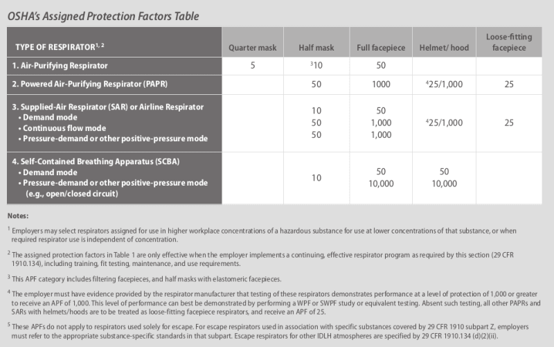

OSHA does not assign a protection factor unless mask fit test is performed. If you really want masks to be protective the annual fit test is essential.

In terms of permissible exposure limits, an ill firing respirator must be better than no respirator at all. However, it's difficult to determine whether one's exposure is permissible without control of the fit.
With that said, there is no PEL for viruses. Theoretically, infection can start with a single virus exposure.
