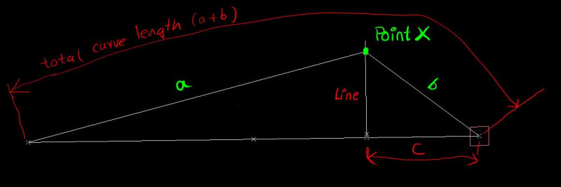

I like to create a Point X on line ). But Like to meet a criteria. a+b must be to my input.
I have tried with While statement but did not work. any ideas. appreciate it .

Hi , I know the Total length of of the curve. user will input that length.
Also I know the curve length -C too
i solved it with few trails..
used while command..
for i while A+B < something
create point on line X
i = i+1
