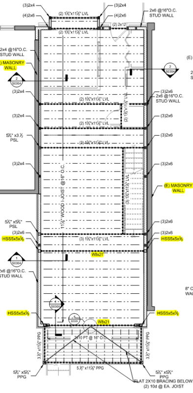

I am not very familiar with residential buildings and wood construction (only been working in this area for 3 years, so forgive me if the answer is so obvious). This is what I have done for a single-family row house rear and one-story addition (20'x50'). For the short side, there is not really any shear wall segments that can be used for design due to the large opening in the rear wall. I have added 2 steel moment frames. The GC is not happy and argued over an hour and talking to the owner about engaging another engineer to redesign. He was arguing that in 20 years of his experience, no one asked for steel moment frame in single family. So, this got me thinking, am I missing some exceptions in IBC for row houses? As far as I know, row house should be designed independently for lateral forces (not allowed to rely on adjacent structure). Any tips or ideas for more economical solution will be appreciated. If I am indeed over-engineering, I would like to change ASAP. Otherwise, I don't mind losing clients. Thanks for reading.
img ]
How are the row houses organized? Are they individual owners with separate titles or is there a strata / co-op / HOA thing that collectively owns the structure with interests for each of the individual owners? The former would be individual structures with zero setback to the property line. The latter would be potentially combined structures.
They are all individual owners. No HOA or any collective organization; they can modify or even completely raze as they like. So, it's the individual structure. It is designed as individual.
Not sure how others get away with it. I have checked someone else's calculation for similar case of wood wall rear addition; they mentioned 'by inspection it is ok' in their calculation report. And it's a mid-size company who does lot of big projects too.

You're in the wrong code, for one, it sounds like it's International Residential Code. There's language in there for structural independence for townhomes, and yes, when they can demolish the one in the middle they all need to support themselves.
Short answer: NO, they all need a viable lateral system that meets IRC or is designed to engineering standards. Even if it were under the building code the same thing would apply. There's a lot line effectively between all of these units. Unless there's something really atypical going on here, i.e. there's an architect involved, they are all on a common foundation, and they have a unified set of fire design details to be an aggregate structure somehow, (I mean two hour fire walls or maybe more between the units).
If you can justify the individual unit as a rigid diaphragm that would enable the open front, potentially. If we are talking wood construction.
The reason the contractor has "never seen this" is because he's using the wrong engineers.
"By inspection it is okay," these folks need to be reported to the board. To me, this is not appropriate and it not the standard of care, either. This is hand waving where we are expected to do calculations. (See other thread: Several of those disciplinary actions involve "designs" with no calculations behind them.)

Also, I don't see your plan dimensions, but there are limits on wood floor and diaphragm aspect ratios. They didn't give you any realistic options here with that front and back elevation, you don't have a real rigid diaphragm option unless you somehow get a shear wall in the middle of the building running left-right. And I'd rather not mix a 2x4 stud wall and a 2x6 stud wall along the same line of force, considering the top plate is a discontinuous mess, and that's the diaphragm collector for the North south direction.
I think I read in structure mag an article about using semi rigid diaphragms and 3 sided braced walls for open front structures, iirc it was for steel though. Would depend on your seismic loads if this is feasible or not though, and some pencil sharpening of course.
Three sided structures are fine and pretty normal. You use the pair to take the eccentricity of the unpaired wall in the other direction. This one looks like it doesn't have a place for a shear wall at all in one of the directions, so you can't do that. You can move the moment around reasonably easily to get stability, but the shear needs to go somewhere.
It's a 4 story above grade; so, IBC. Open front structure never really worked for any of our projects so far. Arch wants open space; they don't give us any interior stacked wall to help us. On other hand, GC always complains why we did not use wood wall instead of moment frame. So stuck between them
Not really, you owe a duty to the public to design a safe structure, you're not strictly in the business of making the client HAPPY. That's what all the language about "when your decisions as a Professional Engineer are overridden and create a public danger...." are about.
As to the three sided diaphragm, look at the plan, there's not much structurally on the north and south sides of the drawings so it's a box but there's no third side.

Ah yeah, I didn't actually see the plan attached to the first post since they are usually attachments, just going off the description. Moment frames it is
Well you could do a steel braced frame and run the braces through the doors and windows. Or perhaps a flying buttress on the outside?
I don't see a lot of feasible options besides a steel moment frame. I suppose a cantilever column system could be entertained, but it's just an upside down moment frame, with extra foundation.
ETA - I don't see a second moment frame though, so this is a three sided "open" diaphragm that has some aspect ratio issues to deal with as well. Open front structures are subject to a lot of limitations in the SDPWS.
If you're doing a moment frame, you could put just one in the middle to minimize eccentricity and then use the diaphragm to take out the balance. So, use the three sided building idea but locate the lateral system to minimize the eccentricity you need to deal with. That being said, you could likely put it anywhere if your entire side walls are potentially shear walls. You've likely got lots of capacity.
You could also see if you have enough space to use one of the Simpson Strong Wall portal frames if that optically feels better to your client.
Or buy enough space to get some strong wall panels in
The limitations on cantilever (wood) diaphragms need to be respected, however. An "H" shape, as you describe it, could work, but there are limitations on the aspect ratio of the diaphragm. If the building is long enough, it would need a sort of double crossbar H to keep the aspect ratios within limits. The drawing above doesn't have dimensions...

I don't see a W8x21 beam as offering much in terms of deflection control especially when mated to an HSS column, and the two moment frames are way on the bottom of the page, so there's a pretty big cantilever toward the top of the page. Aspect ratios are also questionable.
