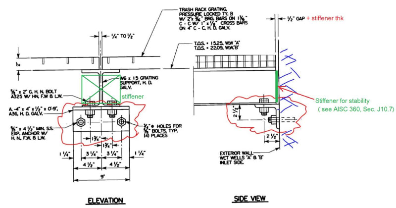

I am working on verify an angle connection that is being attached to a concrete wall in order to support a wide flange beam. The W-Beam is resting/beaning on top of the angle.
I have attached an example of the situation I have in the link ( the red clouded angle is the connection in question):

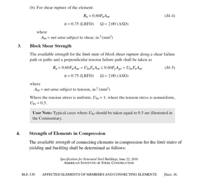

After checking the actual angle for moment stress, shear stress, and deflection I wanted to verify what the additional limit states that need to be satisfied for an angle connection.
Section J4 in the AISC Manual talks about limit states to be considered for connecting elements ( please see images below).
For the condition shown in the link, it appears that "Strength of Elements in Shear", "Strength of Elements in Compression", and "Block Shear Strength" need to be checked, per AISC Section J4. Please feel free to comment if there are any other special requirements for angle connections.
What about "flexural rupture" for the angle connection?
Would these be the only limit states that need to be satisfied or is there another section of the manual that I need to consider since the connecting member in questions is an angle?

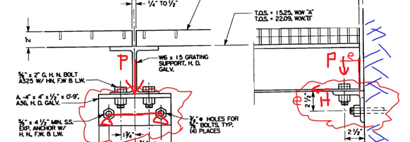

In general, I'll check the seating leg for P*eh, and H*ev about the center line of anchors for the vertical leg. A stiffener plate is required if the legs failed the check. I'll also treat the angle as a short beam simply supported at the anchors, and check resulting shear and bending. You don't have block shear problem, but it wouldn't hurt to check bearing strength at the holes.
Block shear limit state does not control due to the presence of the OSL. I think flexural rupture doesn't control either, but you can assess this limit state by assuming a critical section on the OSL bolt line. Depending on the lb-distance, the eccentricity can be very small or even negative, so flexural rupture would not apply.

If the clip is fixed to the beam, then there is just shear at the clip/concrete interface.
It is more conservative (and likely more correct) to consider the clip pinned at the beam. In this case the clip experiences shear and flexure at the clip/concrete interface.
P*e = T*d. Often, e is about 2d so T is 2P. The anchors get designed for P in shear and 2P in tension.

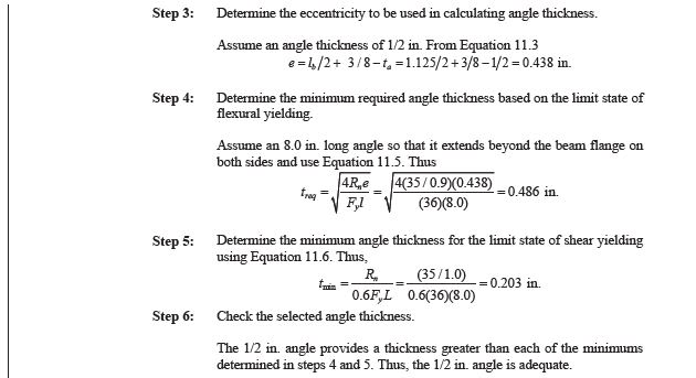

dik said:
Due to the difference in beam stiffness and angle stiffness, I usually consider the lb dimension closer to the end of the beam. The free end of the angle deflects and the load occurs near the end. Any thoughts on that?
dik, I think it would be a logical approach, but it can be unconservative depending on the angle thickness. Attached is a quite straightforward and reasonably conservative design model for unstiffened seated connections. The design values in the AISC Manual Table 10-5 are based on this design model.
This design example is for a welded seat angle, but the design model is the same for bolted seated connections.
Reference: Unified Design of Steel Structures, 3rd Ed.

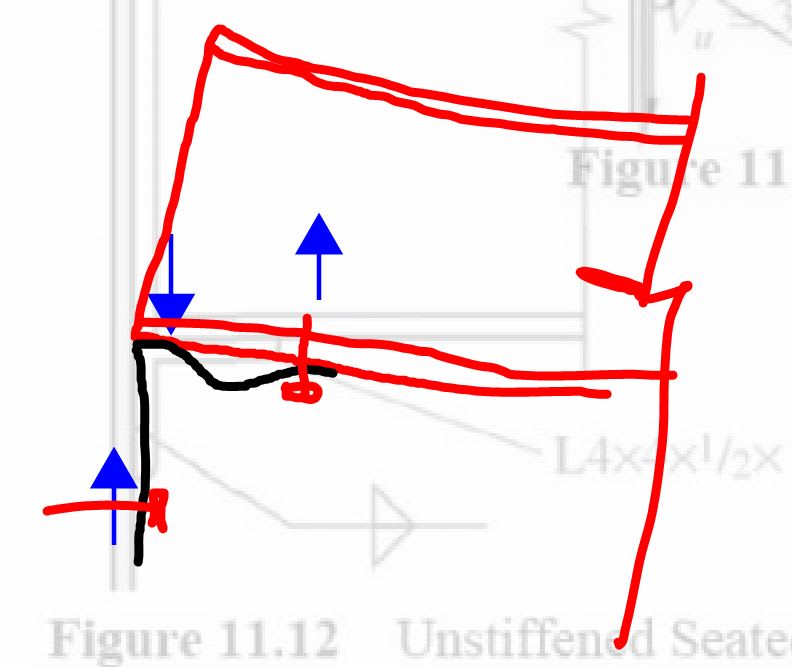

Of course your real load path is probably something like the sketch below util the beam fastener gives way. And that's a good thing as far as the anchorage connection goes. Keeping things mostly pure sure in the anchorage for as long as possible is appealing.
Thank you for this reference. Since you posted these images, I was able to go back and obtain the design example from this book.
I have a question? Using the specific forces, angle section, and beam section for my situation, if I was to obtain a negative "N min" number when Determining the minimum required bearing length for web yielding would I use the absolute value of the "N min" that I calculated or consider that an "Nmin" equal to zero is acceptable?
I also have the same question regarding a negative "N min" when Determining the minimum required bearing length for web crippling, assuming that N/d < 0.2. Would I either use the absolute value of the negative number or consider my "N min" value to be equal to zero?
I am thinking negative "N min" value would demonstrate that the bearing length is negligible due to the applied load, but i would like to verify/confirm.
