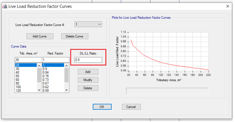

Another question, a column has a tributary area of 20 sq. meter. If the total number of stories is 10, then am I going to consider 20x10=200 sq. meter area while calculating the LLRF for that column at the lowest story?

What is this DL/LL ratio if anyone knows?

Not sure about your codes, but in the States ASCE7 does it based on total influence area (related to tributary area) supported by the column...not individual floors. Then there's a cap on it of something like 0.4*L[sub]o[/sub]...you can't reduce it any lower than 40% of the original, full live load.
I imagine DL/LL ratio is the dead to live load ratio. Take your dead load and divide it by your live load. If it alters your curve, then I'd say it's probably supposed to be unreduced live load for calculating the ratio...but again...I work under a different code so I could be way off.

I don't understand what could be the relation between DL/LL ratio with the live load reduction. If you are aware of any texts in that regard, please share.

Locally here (Canada) it is applied per member, so your second method would be how we calculate it. The reduction factor on the top column would be 0.9, but for the foundation it would be 0.645. And appropriately modified for the columns in between.

Ah...that's Etabs, isn't it? Haven't seen that logo in a while. Makes sense. Odd that it would be lumped in with LL reduction, though?
