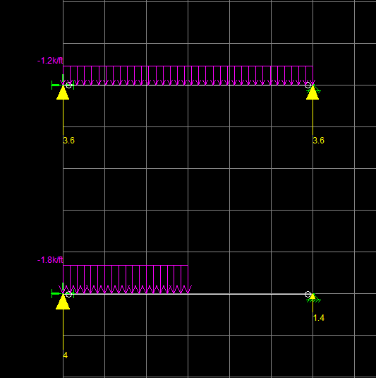

Hi all,
What are engineers out there doing for long span situations where a girder is eligible for a live load reduction (floor live load, trib area>400sf--ASCE 7), but the trib area for the connection at either end of the girder is <400sf (ie 700sf for the girder, 350 sf for the connection).

If I understand you correctly, you're saying that, in essence, the lower bound connection capacity for a beam using live load reduction should be the non reduced live load multiplied by the threshold tributary area for beginning live load reduction applied as a uniform load to the end of the beam commensurate with the trib width - right? I can see the logic there. I may have a 6 foot beam there, but I could have a 3 foot beam. And that 3 foot beam would actually have a higher roof live load reaction than the 6 foot beam.
But here's where I disagree: you've created a double standard. The beam shear and the reaction are the same. So if you're using reduced live load for your member size you're designing the beam for a shear capacity of 3.6kips. But then you're forcing your connection to be 4kips. While it doesn't make sense at this scale, if you factor it up by an order of magnitude you could easily get yourself into a situation where you have a beam that works (maybe it has a shear capacity of 38 kips) but then your connection calculations won't work because the you can't get your 40kips of shear resistance at your connection.
The other issue is that I think you're giving the statistical variations too much credit. The listed live loads tend to be localized maximums - it's why we get to reduce them (or most of them, anyway) for large influence areas. Those loads are defined to create a statistical reliability. While I've started delving into this in more detail (and discovering it's not as widely discussed/understood as it should be), I'm far from an expert. But my hunch is that these statistical reductions leave us with a viable lower bound. That is, the beam shears are accurate or better and the beam moments remain further to the conservative side. That hunch is reinforced by the fact that most reducible loads are based on a 50 year reference period, and live load reduction has been around for about 50 years now (according to the ASCE 7-10 commentary and my own arithmetic). Have you heard of any beam shear failures resulting from live load reduction underestimating the loading concentrated to one end?
The live load being imposed on a beam doesn't know that the beam and connections have a certain influence area. I don't see why a live load can't be partially placed over an area as shown which would cause the maximum end reaction. Similar to skip loaded continuous beams. The "tributary" loaded area is less for a roof beam in the second case shown.
I see there being two different loaded area possibilities for the two examples, with the member and connection having the same influence area for each case (but the first case is twice the load TRIBUTARY area of the second). If we use only the first example, then we wouldn't be getting the worst case of a partial live placement. I used a roof beam in the examples for simplicity. To me it is similar checking a truss web member locally for full live load and then the full truss for reduced live.
