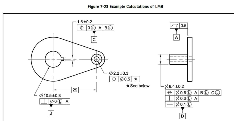

I'm trying to understand this callout that I think is illegal b/c I always default to physical hard gages.
So this primary datum is the exterior neck diameter of a screw. And the thru hole on the part is the position tolerance callout that uses LMB on datum B.
If you use LMB on an exterior diameter you in essence are saying go grab me the smallest collet that you can at this parts smallest diameter. Therefore, the part could never bounce around inside the collect.
It seems the virtual condition of this diameter datum B is the smallest it could ever be made at, so how can you physically make a gage for this and let the part move around at the same time?
LMC and LMB mean - the more material that is there the less caring the user has to be about where the feature is as long as the least material size/boundary is within that glob.
The answer - you cannot gauge LMC or LMB. The limiting surface is within the material where a gauge cannot reach unless the feature is at LMC size/LMB condition.
The typical use is for cast raised bosses where if the boss is at LMC then it's location is tightly controlled so that a hole drilled into that boss has sufficient metal around it, or if the feature is milled around the perimeter there will be full cleanup of the cast surface. If the boss gets bigger than the center of the boss can be farther away. One way to "gauge" that is to take a scribe and carve that LMC boundary at the true position on the top of the boss to see that it doesn't fall off.
It's typical use is if maintaining some minimum wall thickness is a priority.

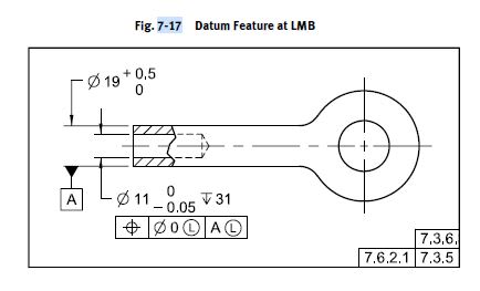

In that thread greenimi listed two areas in the standard that had figures for LMB for datum shift:
"7-23/2018 has some L's on datum features shown"
"See 7-17/2009"
I've attached those below...

One typically cannot create a datum feature simulator for LMC or LMB so being unable to move such a physical simulator doesn't matter.
Imagine for Figure 7-17 the outer surface is at the least material condition. Then the hole is centered up on that. When there is more material on the outside the hole can wander off center because the LMB has more room to move. Same thing with the hole. The more material the hole has the smaller it is and therefore also has more room to move. In both cases neither surface can violate the related least material boundary so there is always that minimum radial material between them.
Figure 7-23 is so contrived I have no interest.
7-23 took me a while to wrap my head around...

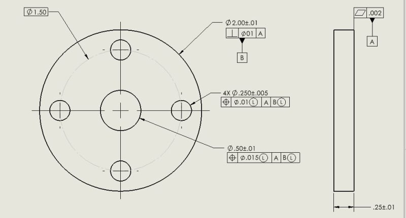

Seeing this callout was a learning lesson for me, bc I've only seen LMC on single features so not being able to build a hard gage setup never confused me b/c it was as simple as just getting the diameter of the feature and doing the math.
As I made the drawing below, I thought LMB on the datum shift would just be a nightmare vs a single feature b/c with a single feature it seems datum shift is just additional tolerance, but with the pattern you can't just assume it is additional tolerance so things get crazy complicated. Then I realized even with a pattern LMC modifier on the 4X individual features you again have no way to build a gage at virtual condition so regardless if the is an LMB datum shift modifier or not a pattern at LMC is still complicated.

What I asked about when starting that thread and what Dean answered on, is the listing of a "minimum material envelope" as a possible type of datum feature simulator (which is, if not an error in the standard, something that can only be specified by a custom note on the drawing).
The LMB ("least material boundary"), which is invoked by the circled M near the datum feature letter in the feature control frame, is a different thing. It is generally the LMC limit of size for a primary datum feature, or the LMC limit of size minus the applicable geometric tolerance which governs the datum feature's orientation or location relative to preceding datum features in case of a secondary or tertiary datum feature specified at LMB. It is true that an LMB datum feature simulator can't be a physical device, but the standard doesn't limit the concept of a datum feature simulator to physical fixtures. If you look up "datum feature simulator" in the standard you will see "the physical boundary" in the definition, but then below it there is a note with examples that also include "a mathematical simulation".
