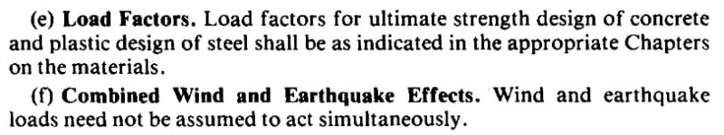

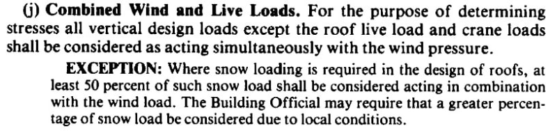

I am looking for where the load combinations are located in the 1976 UBC, if there are load combinations specified?
They are scattered throughout the code. For example, 2303 says:
and 2311 says:
Thanks, I am checking wood beams (dimensional and glulam) as well as connections so will use these plus Chapter 25. Just wanted to make sure I was not missing some other place where specifically identified.
