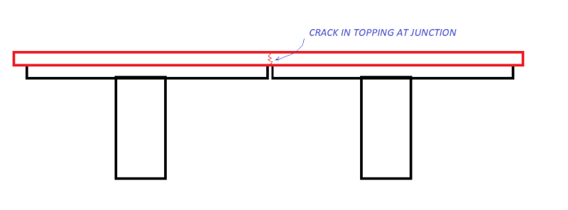

One thing I'd like to check with you - does your model account for reductions in shear stiffness once the topping fully cracks at the junction between the T beams ?
If the junction gets through cracks (likely if it's very thin), the only load transfer mechanisms would be tension carried by steel and compression from the two Ts wanting to press up against each other (ignoring shear friction available to the concrete post cracking and any stiffness arising from rebar dowel actions). This might reduce the overall load transfer further between the two.

I don't think any analysis tool can consider these detailed variables.
Too abstract and advanced expectation beyond reality [idea]

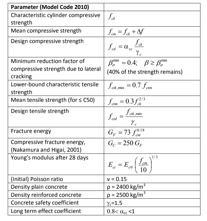

The material properties for the concrete are below. I may look at the other material models that might be more applicable in a case like this. The mesh size is likely another problem. These models can take some time, and one usually works out the kinks before refining the mesh size. This is also the point where I would reach out to the experts for advice.
I did try adding an interface material between the topping and the tees. As expected that leads to convergence problems in the load steps. I tested two different options and neither work great, but there is notable tension between the topping and the tees. In addition to the shear, I think adhesion may play a role in the load share question. I tend to agree that this problem has a few too many variables, but I will pay more attention to a few details in the future as a result of the discussion.
