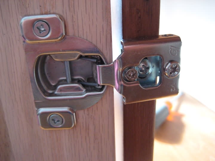

Reason? The doors are at low level and vulnerable to someone purposely or accidentally pushing the door beyond 105deg where the hinges are at their limit. This could lever the one screw holding and likely break the 3/4x1.5" frame. This picture shows the hinge almost at it's limit

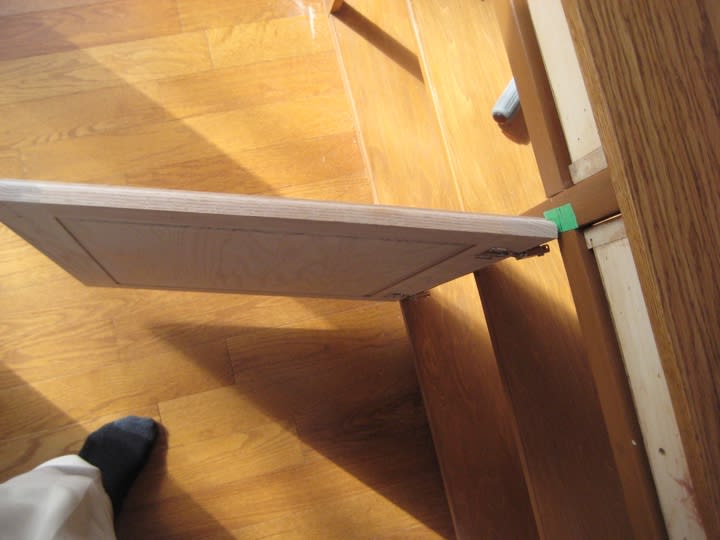

The diagram is a plan view - or bird's eye view if you like. Added pic below.
What I am interested in, is the difference in load on the single mounting screw with and without the wire restraint. And also, the value of force on the wire mounting screws if the restraint is used.
The case without the restraint is harder to visualize or calculate. Once the hinge gets to 105deg, the door and the hinge mount plate would act as single lever. Only support/pivot is at 1/2 the thickness of the frame (3/8"). Would this mean the 10lb force would result in 10*(30/0.375) = 800 lbs pull on the mounting screw? Very high regardless. Thus the need for a restraint.

You can make fun of my concern, but they sell thousands of restraints of different types for just this type of use. The face front verticals on our cabinet are particularly vulnerable. They are a soft wood, just 0.75"x1.5". And unlike the clip-top Euro type hinges used on many kitchen cabinets, our Compact hinges use just one screw for mounting.

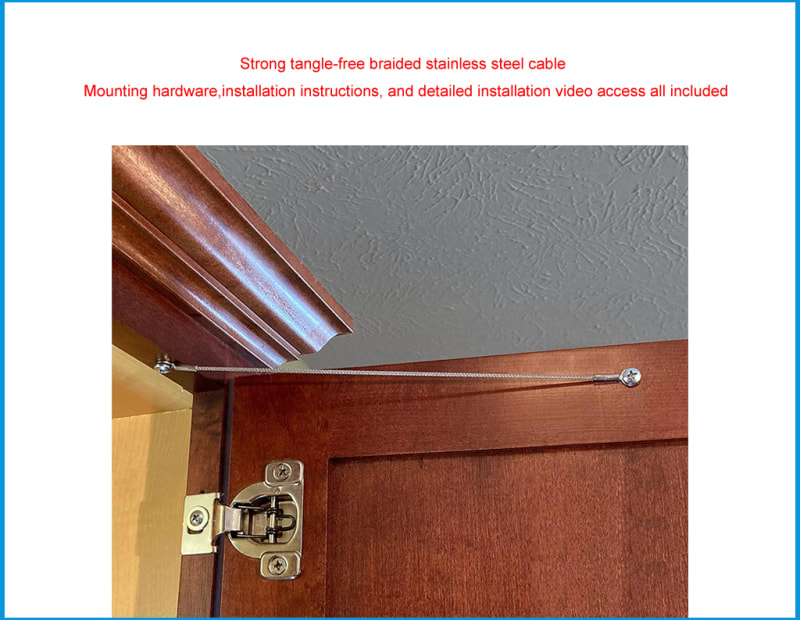

rb1957 - Agree that the wire restraints are not elegant. And I wouldn't use them. But it seems many do. (see picture below)

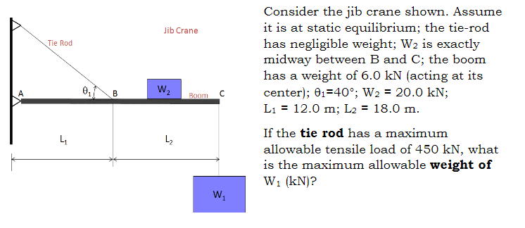

Something like this jib crane homework task I found on the net.
