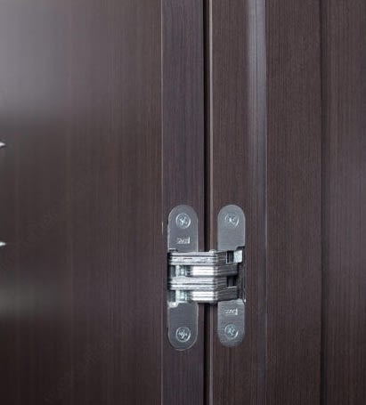

OK, while looking realized that a hinge that opens 180deg or even 170deg will also have to move outwards sufficiently to allow the door to clear the adjacent 1" thick door. Don't see any cabinet type hinges that can do that.
I've found a cabinet hinge in our kitchen that's a 6 bar linkage, which allows 170 deg rotation and some outwards translation. It's a real beauty.

I have seen that type of hinge. Not common on household cabinets. They are an interesting design, but quite expensive! Picture of that type below. I didn't find any Euro style concealed hinges that work on a face-front cabinet that move outwards to clear the adjacent door and open ~170deg.
Looks like I am back to adding either a solid or wire restraint. If nothing else will 'reduce' chance of damage when someone open the doors a little to aggressively! Restraints I have looked at are rated for 10KG or 22lb. Door width is actually 20" and anchor points for restraint 7" both ways (45deg). Allowable load at edge of door would then be 22*sin45*7/20 = 5.4lb. Not much, but better than nothing ;)
