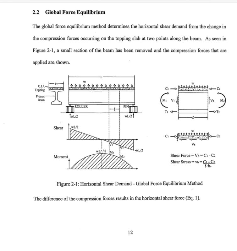

Hi Folks,
Anyone could please explain the principle shown on above screenshot.
I'd like to understand the relationship between the maximum longitudinal shear and maximum plate tensile resistance when assumed elastic distribution stress.
Thanks for your help.

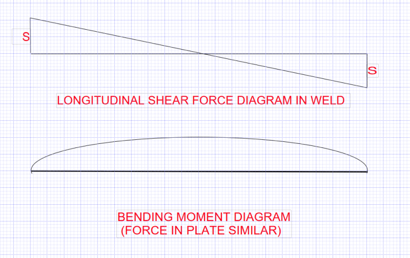

I may have misunderstood the OP's example. But, below is my understanding when tension/compression (normal stress) is involved. To weld this piece to another element, the stress in the weld should at least equal to the stress in the plate everywhere alone the length. Strengthen the ends as indicated in the text below.
The diagram below shows the longitudinal shear per unit length in the weld, the beam moment and the tensile force in the plate. The units of S would be N/mm in the metric system or plf in the Imperial system.
BA
retired13,
We are not talking about P/A in the plate. We are talking about the horizontal force per unit length in the weld to get bending stress into the plate resulting from uniform load on the beam.

Thanks for your answers folks.
I’ve got the following answer from a Boss.
“The maximum tension in the plate is 1437 kN, at midspan. So we know the maximum longitudinal force. This longitudinal force must be transferred between the plate and member. This is clearly conservative, as perhaps the plate is not fully stressed.
The next question is how is the stress distributed over half the span? It must have all transferred by the time you reach the end of the member. One could assume a uniform distribution, and simply divide force by length. That would mean a plastic distribution, and welds are notoriously not plastic. So an elastic distribution was chosen, zero at midspan and rising to some other value, S at the ends.
In compound sections, there is clearly no desire for “slip” between the two plates at midspan. This force (if you like, a desire to slip) is a maximum at the ends,this assumes a triangular distribution of force over half the span.
The maths is then simply working out what the maximum ordinate of this triangle is, S at the end, and simply saying the maximum longitudinal stress is equal to that value, and thus designing the weld for that value. It seems conservative and reasonable to me.”

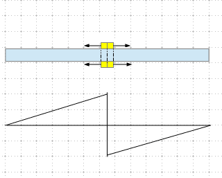

Another way to look at it...the moment at any point x from the support is equal to the area under the Shear Force diagram between the support and Point x.
There are situations where a linear variation between support and midspan is not conservative. One such example is a pair of concentrated loads P, each distance 'a' from each end. Distance 'a' is called the shear span. Moment at point a is P*a. The moment between the loads is constant at P*a (neglecting beam weight), so the weld must develop the strength of the plate in each shear span. Theoretically, it doesn't require any weld in the central section, although normal design practice would be to provide minimal weld in all parts of the span.

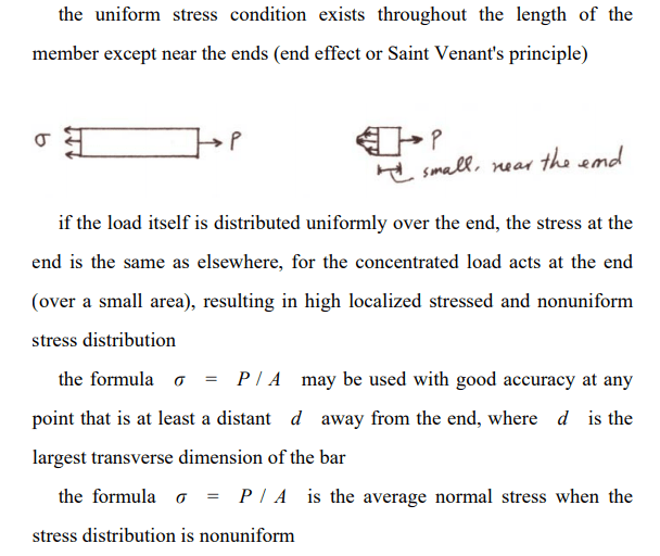

Screenshot below it’s not the OP, but it’s using the same principle, is it correct BAretired?
