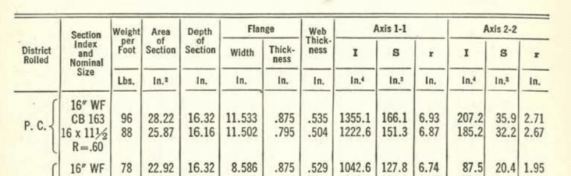

Hello,
I am working on a drawing that has an existing structure and the steel used is an existing 16WF78 beam. I need the beam width for this size beam.
I have gone through so many papers about steel sizes, but I am unable to find anything for this type of beam.
If anyone on this forum is able to help me with this, it would be great. I want to learn more about this type of beam, so if anyone can share a link, please do.
Thanks in advance.
Priya
Thank you for your response. After posting my question, I was able to find a site where I was able to find the answer. Linking the site here for future ref.
Also, I did go to the site you linked in your answer but I wasn't able to find that chart. I really appreciate you took the time to find it for me. I will save it for future use.
