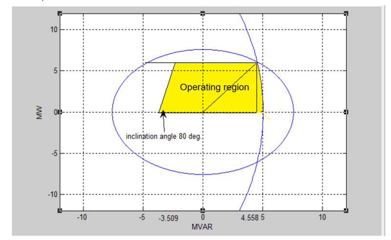

As this machine is quite old, I have made its capability curve using MATLAB, you may have a quick look at it to check it the settings are well within safer zone

The settings you provided seem reasonable to me, except for the 50ms seems a little short, I’d probably put it at half a second or a second to add a little security to the element.
