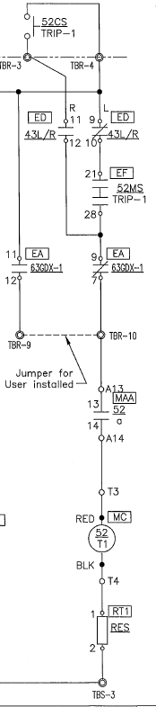

For your own information, my ABB 145PM63-20B breaker control cct has the 63-2 switch pick up a 63X1 relay for trip coil 1 and 63Z2 and 63Z1 relays in trip coil 2 (not sure why the add two relays here, maybe just spare contacts?). 63X1 will pick up trip coil 1 and 63Z2 picks up trip coil 2. 63X1 and 63Z2 are also used to supervise the close coil (block close). I'd upload a schematic, but honestly I'm not sure if it's proprietary or not. Either way you can probably imagine what I'm describing.

marks1080, I'm looking at a schem for an older 145PM40-20 here, but I have the 63-1, -2, -3 pressure switches along with a 33 (spring charge limit switch)all paralleled. These pick up a 63AX which opens a normally closed contact in the CC, TC-1, and TC-2 circuits (lockout on low gas or low spring charge). Alarms are done separately. I have seen newer schematics that had the dual 63 auxiliaries as well.

Example wiring schematic:
