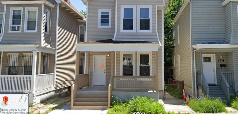

Just a few feet on each side. Check out the street view from June 2022. Red sticker on the door. Was sold a month later, last July.
All of these houses are probably built around the same time with crappy brick basement walls. Too close to do anything from the outside.

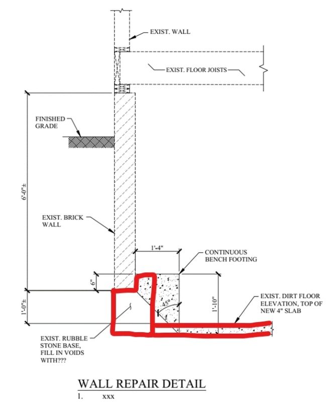

This is what I had sketched up so far after discussing with the contractor. The homeowner is okay with losing some space for a less expensive repair. Of course they would like to keep that 7' clear height so that's why a bench footing seems like the best option here.
But I do feel like this needs to be performed in a stage-like procedure, just because of current condition. Those studs are retaining soil so I don't think I'd want them to remove the whole thing at once. Maybe 8-10ft lengths.
Thoughts?
Where are those 2 x 3 studs in this?
If this was being done before the floor had been lowered then I can see it, but now you need to do something about the missing foundation under the wall surely. The existing foundation, such as it is, under the bricks has been severely compromised and now needs reinforcement.
Can't see why you can't underpin in sections at a time, say 3 ft with some sacrificial support legs
You have to tie that little triangular 'blob' into the wall to restrain it at the top. The bottom of the wall may move. IMHO, not a good fix. You should be looking at 'real' underpinning, else re-do the wall. It's an expensive fix.
In my experience, bench footings generally go underneath the existing wall, and are part of underpinning. You really need a geotekkie for this type of problem.
If the bench and the slab are going in as separate pours, I'd give the bench a bit of a toe, and provide a construction joint detail showing crossing bars if you're going to do it in segments.
I wonder if it would be better, since it looks to be a small house and basement, to do a system of excavation shores a foot up from the existing footing and at or just below grade level to brace the walls against each other, strip everything out, and then pour the whole bench and slab together. Not easy to maneuver around, but most good contractors with experience in this kind of work are able to work around that kind of thing.
Sorry, that detail was pulled from an old job, that I just modified briefly this morning. The 2x's are just right up against the wall currently. You're right that this detail was used in the correct procedure.
Maybe I do a combo of both. Underpinning with a bench-like notch in front to secure the base of those old bricks.
Shore existing walls. Excavate dirt & remove bits of old slab. Pour down about 1'-4" of concrete for underpinning with a notch in front. Do this in a 3-stage approach x 3 ft long sections. Pour floor slab when finished.
What about shoring to prevent against sliding until the new slab is in? Horizontal across the basement short way (16 ft) from wall to wall? Right now they are lucky the soil is pretty stiff, but as all of this is removed in sections I don't want a sliding failure.
dik - that depends. In a small enough basement, the bench can act as a beam, resisting the thrust of the wall and delivering it to the perpendicular benches at each end, which in turn react against the bench on the far side. You can also tie it into the slab and dump the moment there, though the slab gets a lot more expensive.
For the record, I dislike bench footings, probably only did it once before. Underpinning is always my first choice where possible. This is just a tricky one because it's already dug out, it's a 100+ yr old brick wall, & there's no footing to underpin against.
FYI this house is a 35' x 16' rectangle.
Well if you can get them to do underpinning, great. Your detail looks good, but I'd take the underpinning down far enough that it doesn't need the slab to resist any loads. Can you tell where the original basement floor was? Putting the 'mini-bench' up to that level would be a good idea to keep the stresses from retaining in their historic range.
3ft should work. If the wall's in good shape you could probably go to 4ft, but this isn't the place to get greedy.

I've used benching as well as flush with the wall underpinning for numerous foundations... depends on the loading... only once for brick, mostly for field stone foundation walls. The benching is part of the underpinning.
16' span with maximum soil pressure... I wouldn't hang my hat on it.
