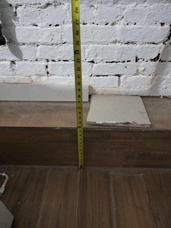

Cheap house flipper lowers the floor of a 1910 basement to gain 7' clear and sell it as a full basement. Old brick walls, no footings, just a rubble base.
They cut out the floor slab and dropped it down about 12"-14" then sheetrocked the whole thing to hide it. Never put a slab back in, just put heavy vinyl flooring right on the dirt.
IMO underpinning is too risky even in small stages, there no existing footing and basically no dirt left around the base of the wall, just "load-bearing" 2x3's.
So that leaves a new proper bench footing. Any thoughts on a good procedure to not compromise this thing any further during construction?
Normally I slope the bottom of a bench footing, but this is cut straight down already so do I have them backfill with something or just pour a whole mess of concrete under there? You can see in the last picture the cavity that exists under some portions of the wall.
You can see it better in this photo of the side wall. They had what looks like a 3" rat slab everywhere, then went down about 7-9" below that for the dig. They left about 3-6" of slab and as you can see from my first photo in the OP, used that cavity to put the studs so that they didn't lose much interior space.
So that's why I'd probably go 6" minimum up with the notch above the existing brick. That would cover the space of the old slab plus a few inches to the next course.
Yes the water issues will still have to be resolved. After they underpin they can put a perimeter drain and sump pump in the corner I would think.
Forgot to include this earlier, but it appears that those clowns did a "bench" only at the front wall and covered it with flooring. I guess because it's a utility/ laundry room they figured no one would think twice, but didn't do it everywhere because it would've been too obvious. They chose the cheaper and easier option to just sheetrock the dirt. Unreal. I couldn't sleep at night if I told someone to do this kind of work.

Looks like I would need a roughly 30" deep footing to get my sliding FOS at 1.0. So only about 10" deeper than I was going to go anyway. That seems worth it to not have to add in additional shoring. Then once the slab is placed it will be braced. What do you think?
I think I'd take it down to get your sliding factor of safety to 1.5 and not rely on the slab. Turning the slab into a compression element would require a much thicker slab and a lot more reinforcement.

Would have to go down to a 5'-4" deep footing to get to 1.5 FOS. That's basically the height of the brick wall and just not realistic to excavate in a situation like this IMO.
They are going to have to shore up the whole house both vertically and horizontally at these basement walls to prevent them from blowing in (a miracle they haven't already). Then keep the horizontal bracing in place until the slab has cured. Just need that slab to brace the base of the wall/footing to keep it reasonably sized.

When I do low bench footings, I use the slab as the toe for a monolithic retaining wall. How are you resisting overturning otherwise?
Fair enough. Shoring it is, then, until the slab is in place.

Have you considered the horizontal reaction at the base of the wall and verify that the "cantilever" bench footing is sufficient to cantilever up from the slab and support said loading while tying into the slab? I would suspect a 6" reinforced slab would be needed minimum.

That's my next step, to check that bench for support.
