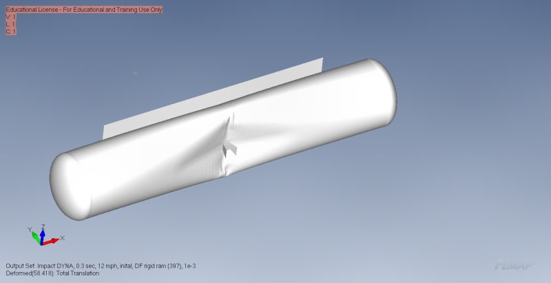

1st plot is with rigid ram. 2nd plot is with more denser ram to speed up the run. Tank is the same. I will run the 2nd case to 0.3 sec and see what I get.
I use student version to learn at home. We dont get a laptop.
FYI, I use FEMAP to setup and DYNA solver.
@rb1957

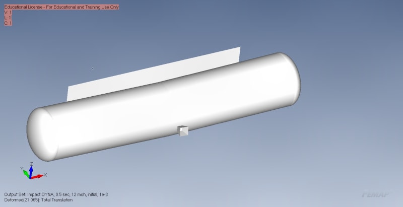

My bad. I guess the ram @ 0.3 sec was a different material. Below plot is the same at the 0.5 second but run till 0.3 sec. Either way initial velocity didn't change the behavior much.
the "Ram" is, I think, the thing hitting the object ("tank" ?) shown. (oh, I think I see now, the ram is that little prism shape ?)
It makes sense for the ram to be rigid. but if the tank doesn't deform (as in your first pic @ 16:20) is the tank rigid material ?
don't understand your last pic ... is all well now ? I would've expected the ram to maintain constant speed until it contacted the tank, then slow to a stop, then the tank would rebound slightly (releasing the elastic energy from the impact). Possibly this rebound velocity would pull the ram away from the tank ?

Yes. Ram is that tiny object. Tank is the cylinder.
Tank is regular steel.
Last pic is same at one before except time is 0.3 sec instead of 0.5 sec.
Still working on it. I do expect a rebound but I do not see any.
It appears that when I use the initial velocity the ram rebounds. But for some reason the tank is rigid.
Below plot is similar to the one @ 16:20 but run till 0.5 sec. You will notice that it has rebounded more than the 0.3 sec plot.
Yes. Tank should look like pic @ 14:59 and ram should rebound as pic @ 16:20.

I just realized that in plots @ 16:20 and 2:31 the ram doesn't really impact the tank. The contact doesn't work. It just goes through the shell a bit and retreats.
But for some reason when the ram density is increased contact is fine. See pic @ 17:16.

The results are very similar to plot @ 17:16.
I increased time to 0.5 sec and the ram kept on going. No rebound.
I have this feeling that the fix is something very trivial that I am missing. No reason for the ram to keep going. It has to stop and rebound a bit.

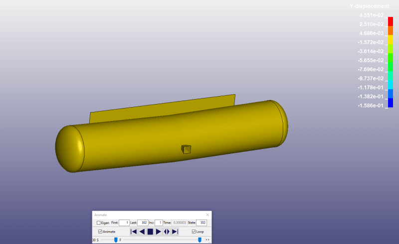

The job is doing precisely what it is set-up to do; I am afraid it is your interpretation where the gap lies.
Plot the displacement history of a node on the ram alongside the visual results, interpret them together, and you will see it for yourself. Pay attention to the first few time steps before the rebound starts.

I do not see any rebound. Please refer to my Y displacement plot for a node on the ram. Maybe I am missing something. Also I did not notice any rebound during plot animation.
